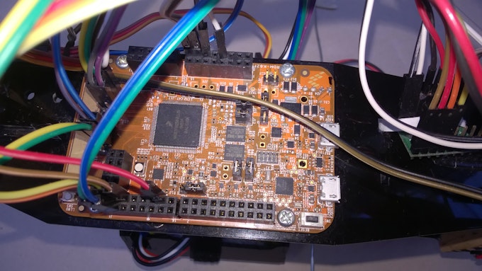

The FRDM-K82F card is used in the design of the control system. The large computing power and the numerous peripherals in the card allow for the required control.

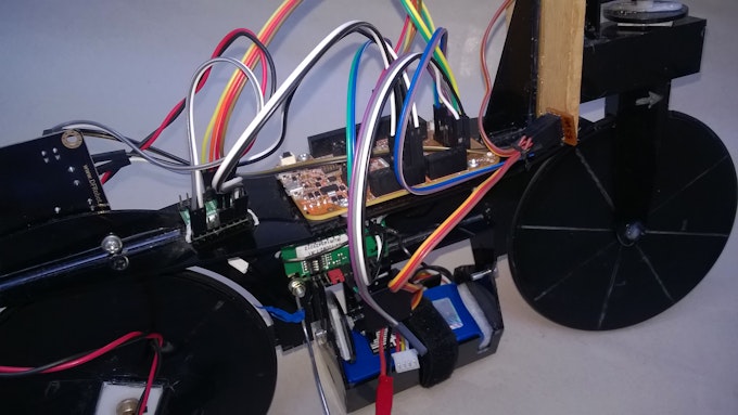

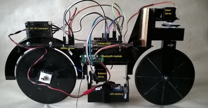

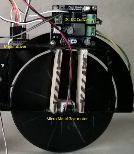

It is important to notice that for this contest only a simple system that meets the basic requirement was designed. The system is based on a closed loop PID control that has been implemented in the FRDM-K82F card. The accelerometer of the card works as an input sensor that determines any change in position in relation to the vertical axis. The control signals are PWM signals; these signals are used to position the servos in the design (See photos 1 - 4).
A counterweight is used for balance and a servo controlling the direction is used as additional aid to keep the balance. (See video 1)
The FLEXIO module is used for I2C communication with the accelerometer.
