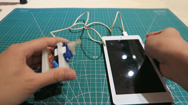

Step one, convert the servo motor to a hand crank generator. Disassemble the servo motor. Desoldering all the wires on the board. Solder the wires and motor together. Also, remember to remove all the locking parts on the gear. After that, you can reassemble all the pieces together.
Step two, solder the boost module, diode, capacity, and server motor together and turn them into a complete circuit. A diode is very important in this circuit. Since the hand crank mechanism can go either clockwise or anti-clockwise, the diode can prevent the current flow in a wrong direction.
A boost module is needed because the servo motor can only generate 1–3 volt which is far from the 5-volt standard to charge our mobile phone.

Wa la, there you go. A hand crank mobile charger that can work in the apocalypse. Of course, you can charge your tablet. You can charge a LED stripe or even a GoPro.
This is not a product that can use on a daily basis because it takes at least a several hours of cranking to charge your phone to 100 percent. This is just a project for fun and learning. So, please save your crank charger until the judgment day. To prevent your phone run out of battery when you need them, why don’t you stop your phone addiction, say stop the unnecessary refreshing of your Instagram feed.
