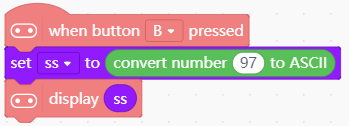

Thanks for your feedback, we will solve it in the next version. Currently, there are two ways to avoid that problem, click the link to see the image
1.
https://raw.githubusercontent.com/Frances9/Mind-image/refs/heads/master/Image%201.png
2.
https://raw.githubusercontent.com/Frances9/Mind-image/refs/heads/master/Image%202.png
