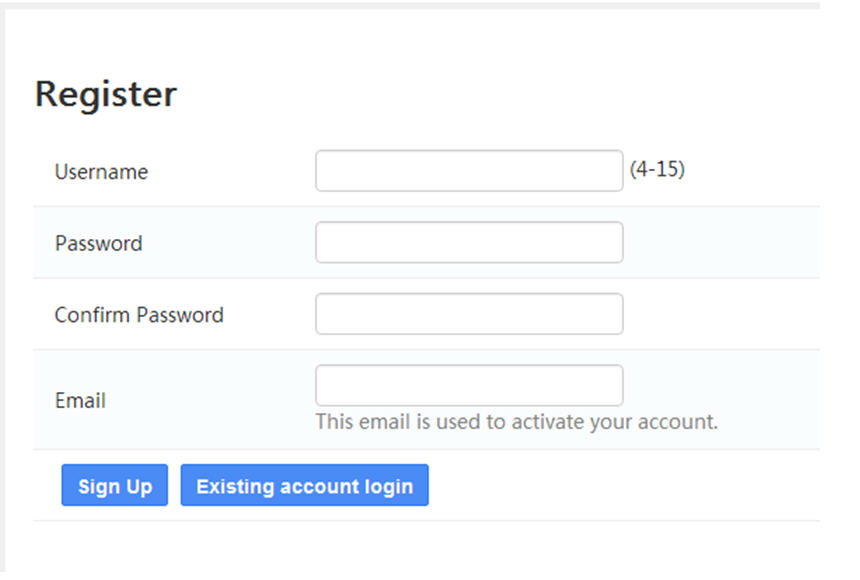

3. An account on DeviceBit.com (http://www.devicebit.com/home/login)

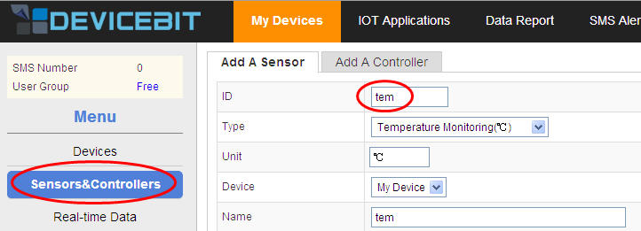

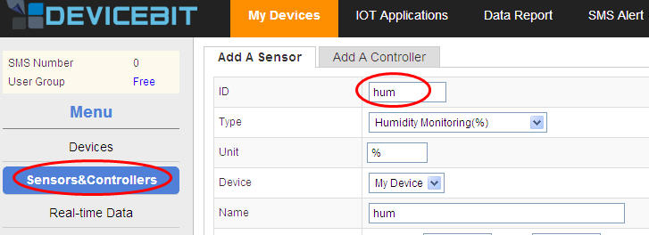

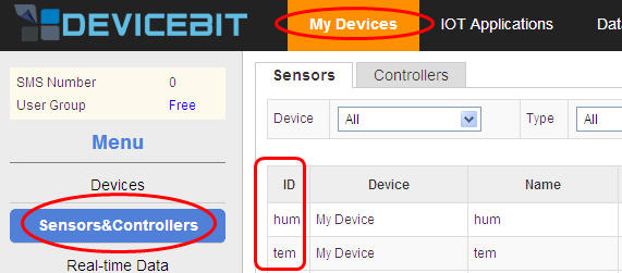

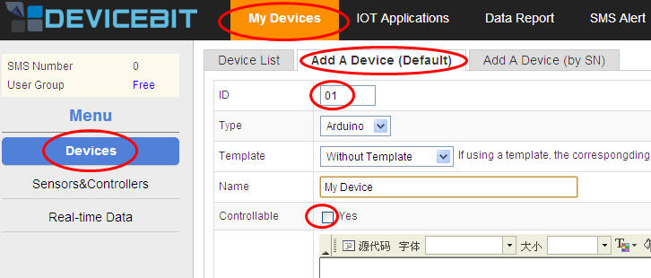

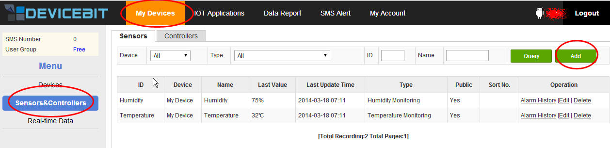

1. Add 2 sensors on the website. One is the temperature sensor, and the other is humidity the sensor just below your device “01”, and remember to untick Yes (set your device’s “controllable” to “No”), because we’ll not control our device at this moment. Edit their ID to “temp” and “hum” respectively, for we will need them in our codes later.

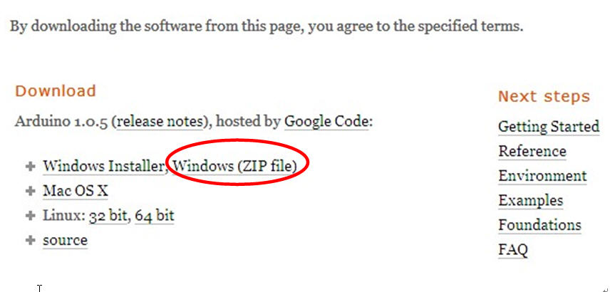

2. Download the arduino IDE from www.arduino.cc. Remember to select the version 1.0.5, not the latest version 1.5.0 by now.

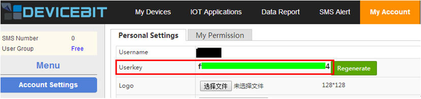

Replace “YOUR_API_KEY_HERE” with your user key in the user center of DeviceBit My account->Account settings.

You need to get these things ready:
