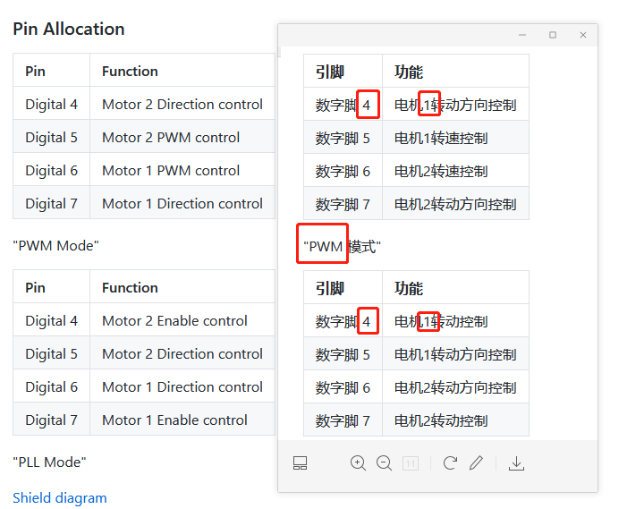

Is the documentation wrong - I found that:
D4 is motor 1 direction
D5 is motor 1 PWM
Hi, Really sorry about it, You are right. We forgot to update the English wiki. Here's the correct one as you mentioned but it's in chinese. We will fix the English documentation soon. https://uploads.disquscdn.c...
