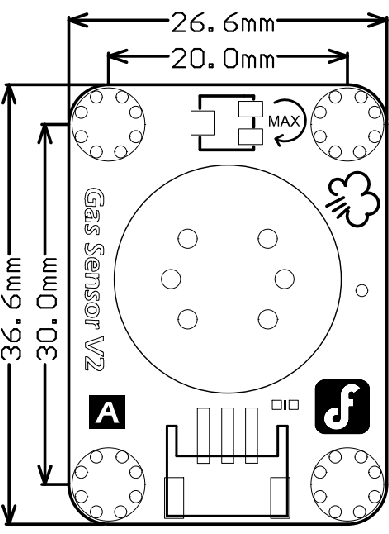

Hope this can help you. The hole size is 3mm.
