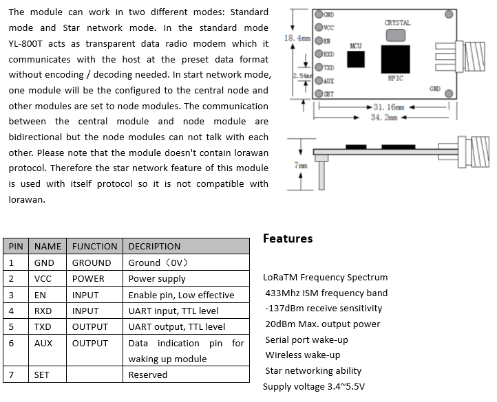

What kind of question do you have, we just find some information about the pin explanation of the module. Hope this can help you. https://uploads.disquscdn.c...
