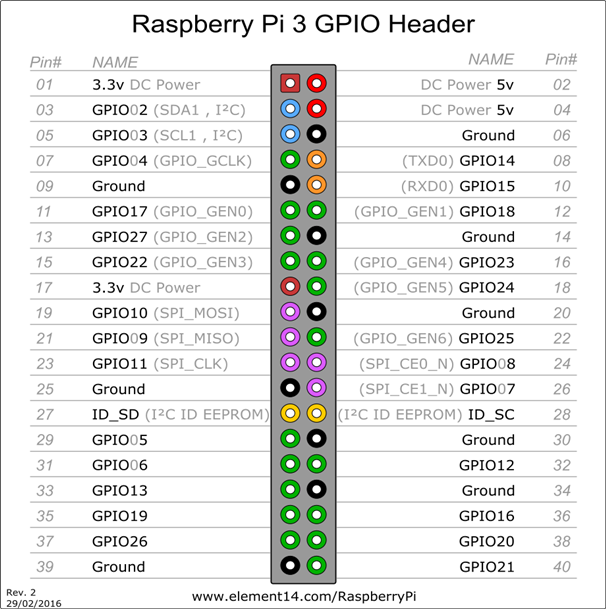

Yes. https://uploads.disquscdn.c...
My question is, can I use this product to connect i2c data to three pairs of ports?
