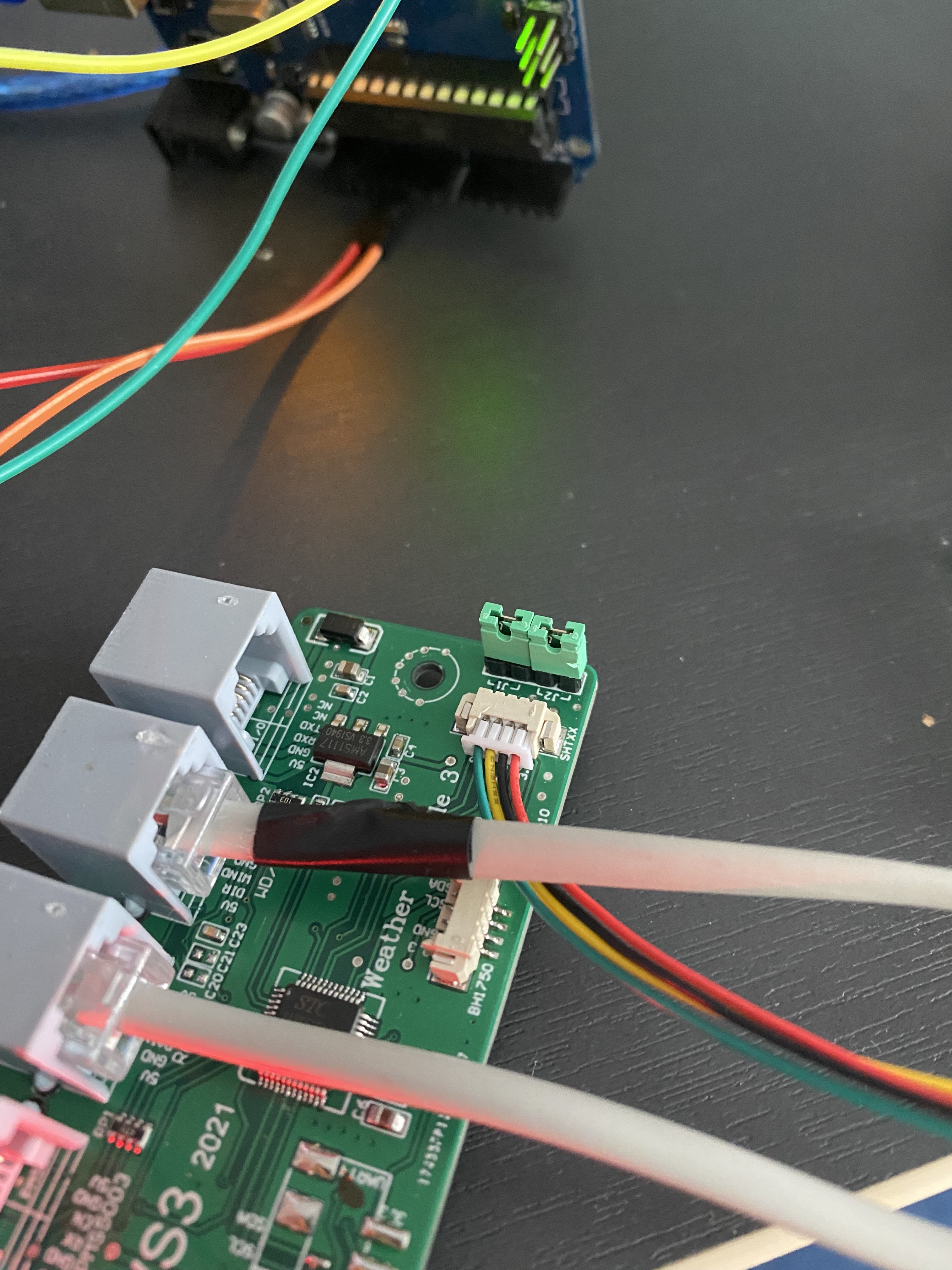

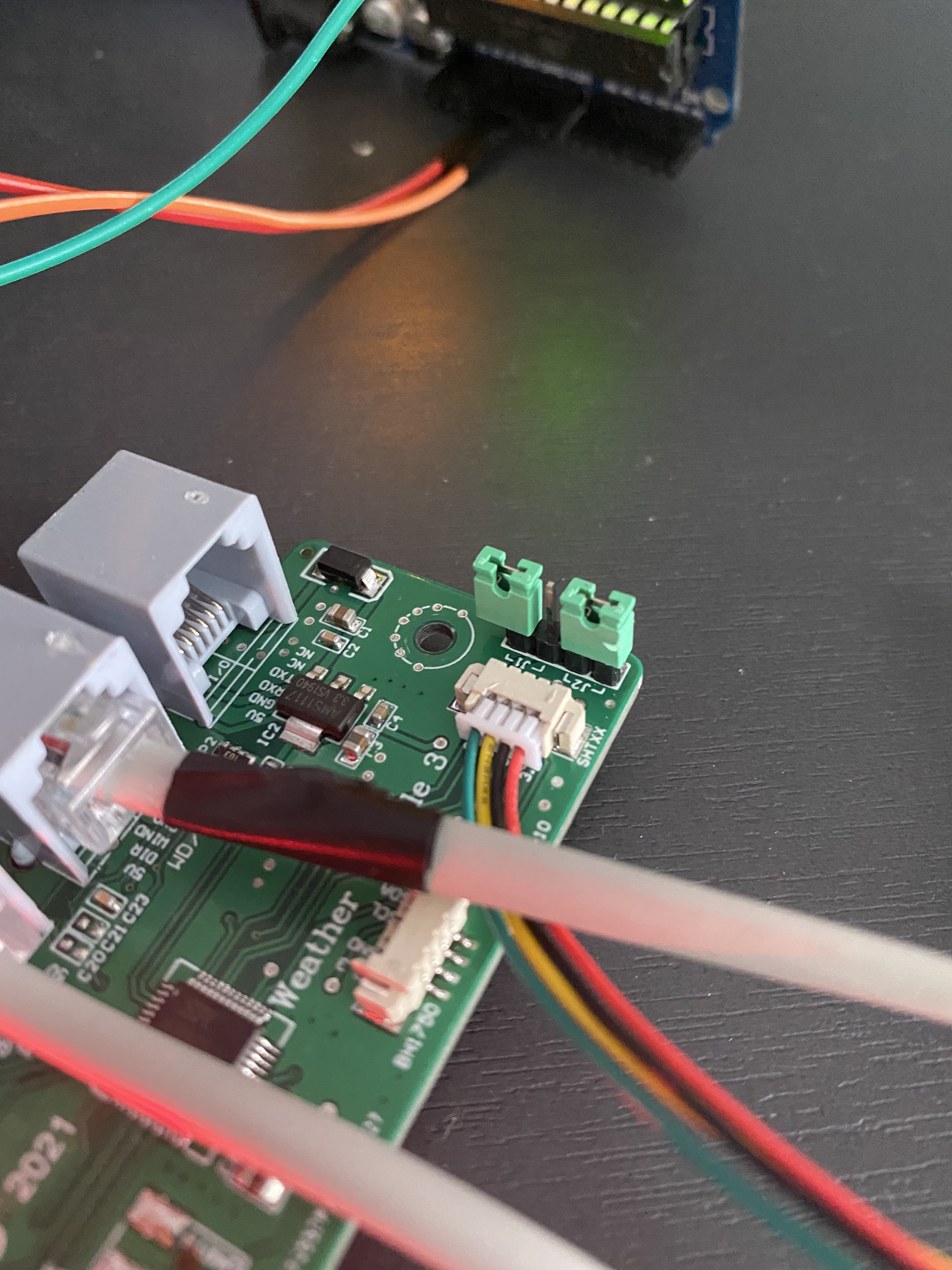

Can I write a new source code and flash it to the Weather station board? if can do that, how do it?
2022-03-24 17:29:35

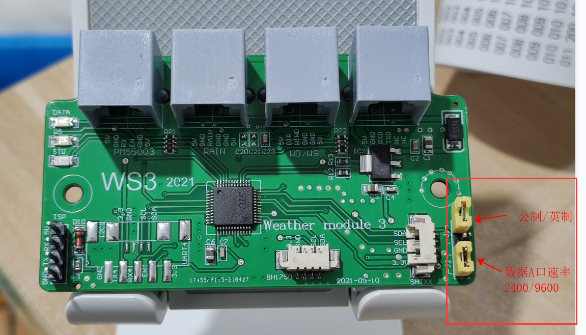

Short circuit the J1 interface on the board and it will work. it will output the data as shown in the wiki.
Thank you :) It works!! The problem has been solved.
Before
After

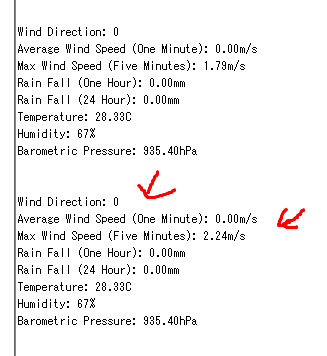

I found that even if the wind direction and wind speed are changed, there is no change in the output value.

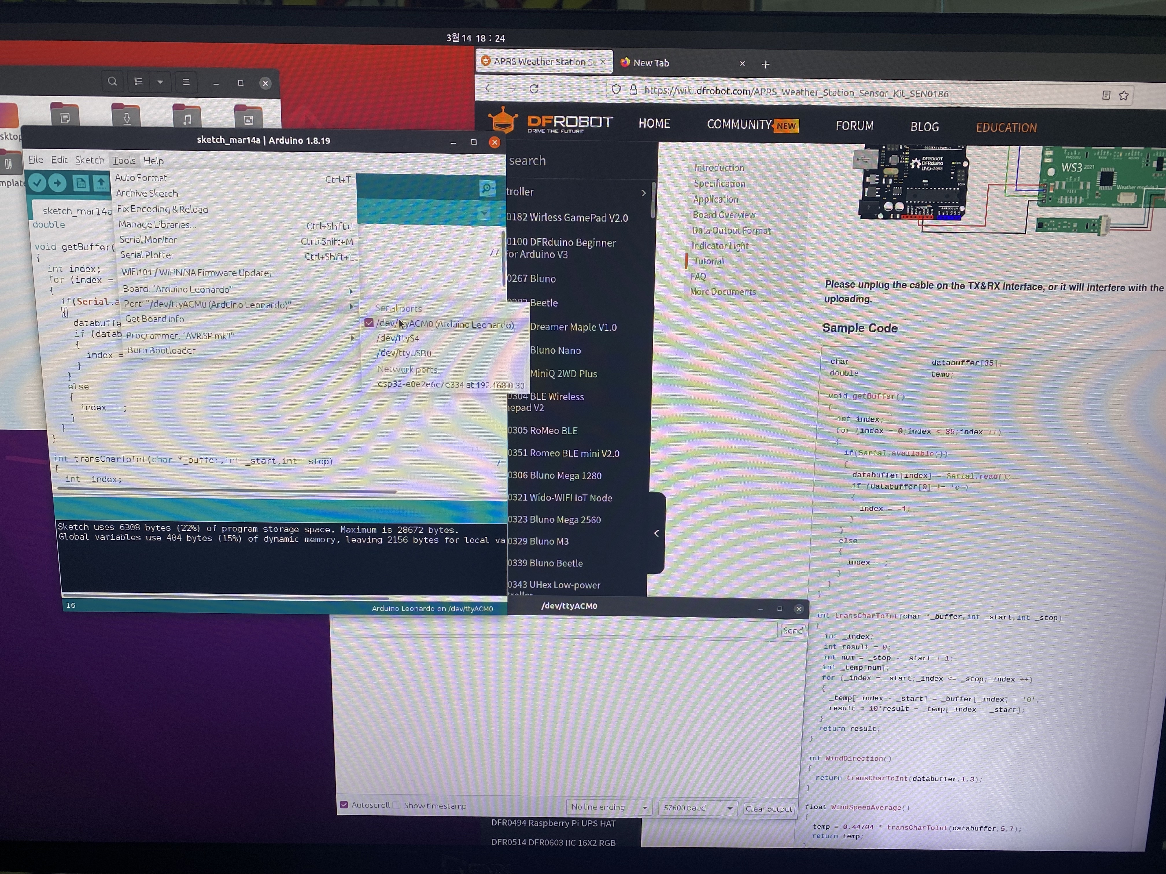

Example code was executed on the latte panda, but it did not work.
(Latte pandas use Arduino Leonardo.) https://uploads.disquscdn.c...
And I wonder if the lower case letters are correct in the example code.
databuffer[0] != 'c'
