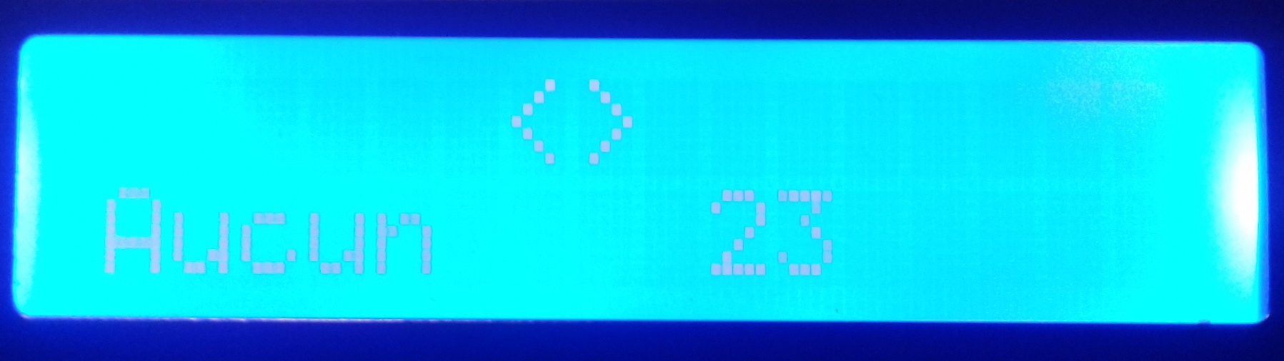

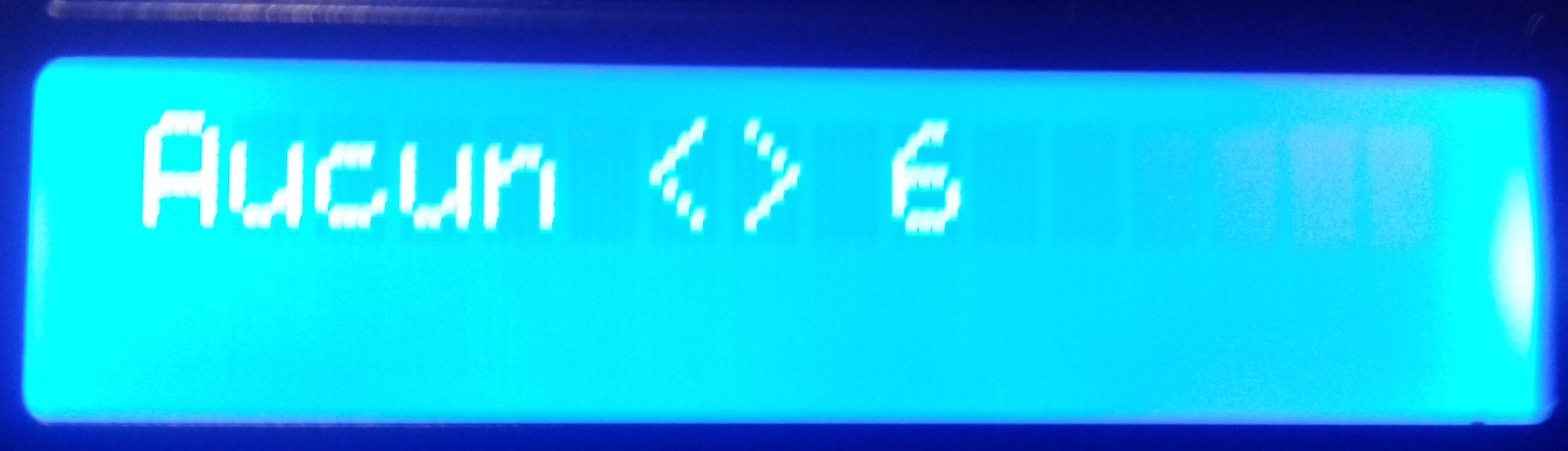

Do not search anymore !
it's the LCD shield that has a fault!
I tested another one that works perfectly
Thanks again...

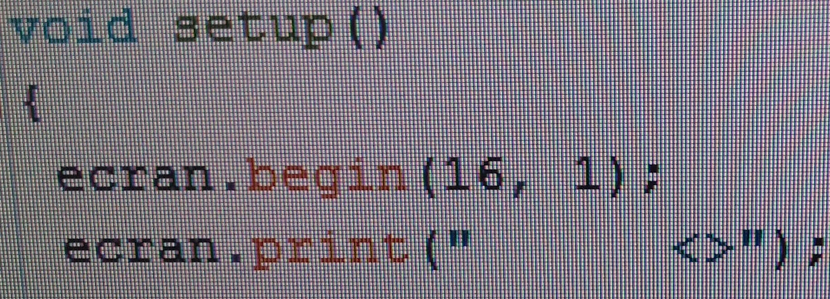

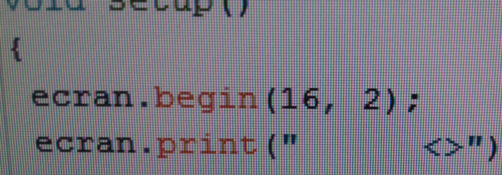

here are the photos of my problem
I use the bookstore (libraries) "LiquidCrystal" https://uploads.disquscdn.c... https://uploads.disquscdn.c... https://uploads.disquscdn.c... https://uploads.disquscdn.c...
Can the screen show when you upload the sample code?
2018-11-13 05:57:52
What is the color of the writing?
if I declare 1 line it is white
but as soon as I declare 2 lines it becomes black
weird no?
