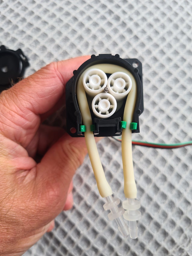

I've purchased one of these pumps, but it's not working properly. The rotor spindle is turning, but the three plastic wheels aren't turning to compress the rubber tube - it's like they're not pressing firmly enough on the spindle to cause them to spin (see attached photo). Can you recommend a way to fix it? https://uploads.disquscdn.c...
Would you try to make the pump turn faster? This pump works on the principle of rotation by friction of the main shaft against the wheels. So it needs the spindle to turn faster to be effective.
