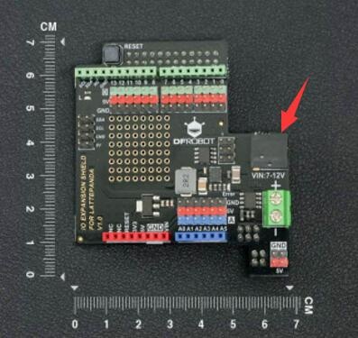

For the external power supply on the shield, can`t find any connection information!
(+)--o )--(-)
or
(-)---o)--(+)
Sorry, I don't understand what your mean.
Does your mean the external power supply which I marked it with arrows in the photo?
If that's what it means, the inside of the power interface is +, and the outside is -.
