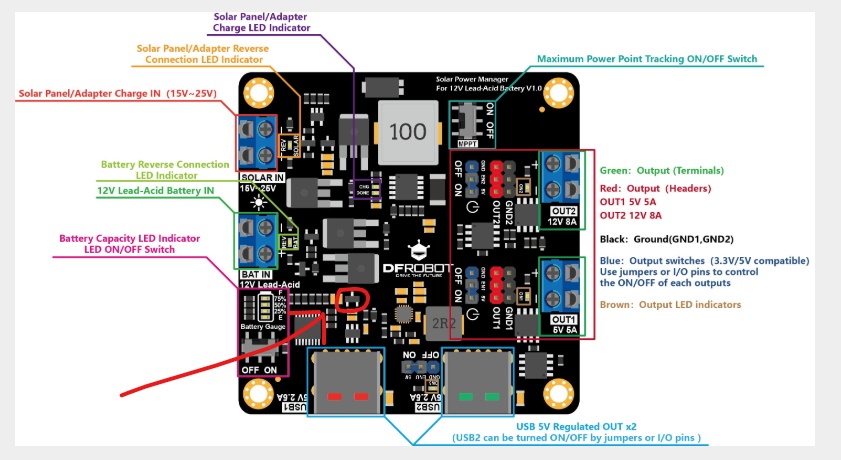

Hi, I have a strange issue with an assumed short, or external ground that happened when connecting a wire to the OUT2 screw terminal. The protection did not kick in and the component marked caught fire instantly.
I realize connecting it while turned on was a mistake, but the reaction seems little extreme for connecting a wire with no device or component attached,
