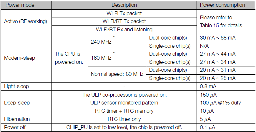

What is the power consumption of Beetle ESP32? Does it support deep sleep? What is the power consumption when it is in deep sleep?
userHead JaneYu 2019-06-18 18:23:26 30 Views19 Replies

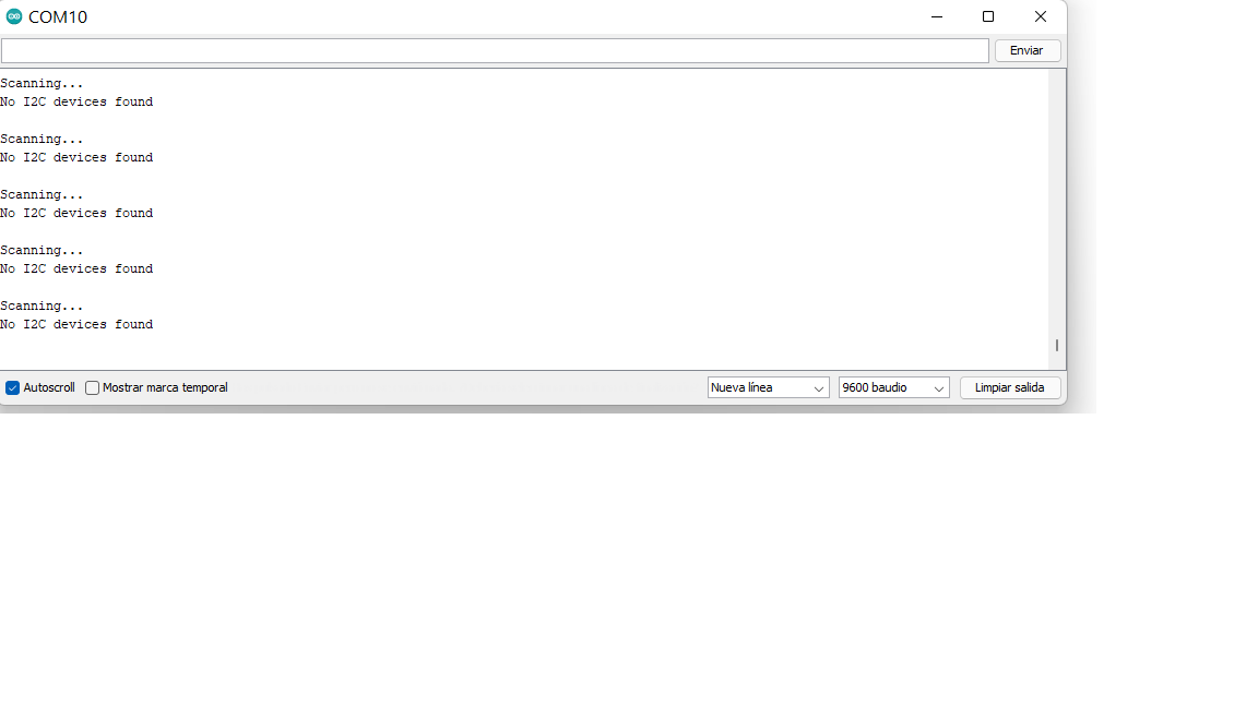

Hello, I bought this module; however, when uploading any program with Arduino using the I2C communication protocol, it does not work. As an example, when I use this simple program to get the I2C addresses.

2020-01-10 18:04:18

The board has hardware SDA and SCL ports that you can directly connect to. This will allow you to directly interface with the i2C communication protocol. Please check out the product wiki here: https://wiki.dfrobot.com/Be...

ESP32 supports deep sleep with power consumption of 30 to 68 mA in normal sleep mode and 100 uu@1% duty in deep sleep mode.
I had bought Beetle Bluno, and then I had learned that its software dos not support deep sleep. SI I could not use it. Is there any problem like this in Beetle ESP32? Can I put it into deep sleep mode easily by the help of Arduino IDE? If yes, can you provide us a complete example code and some current measurement that really show us that it is working? After Beetle Bluno experience, I become a little bit conservative. Thank you.
2019-06-19 17:49:40
I have a Beetle (DFR0575) that I want to use in a battery powered configuration (3xC batteries ~ 4.5 volts) running Micropython. When I put the Beetle in deepsleep it still draws 3.5 - 4.5 mA. I have created a minimal main.py (listed below) and tried this MicroPython 1.16 and 1.17 but it never gets down to the uA level shown in the table. The 'boot.py' is the default with only comments.
After some more checking/testing I was running the battery input in through the microUSB port. When I connected the battery to the solder points directly on the board the current dropped to 0.3 mA when I put it in deepsleep. It seems that the microUSB interface is what is continuing to draw power even if the esp32 is in deepsleep.
