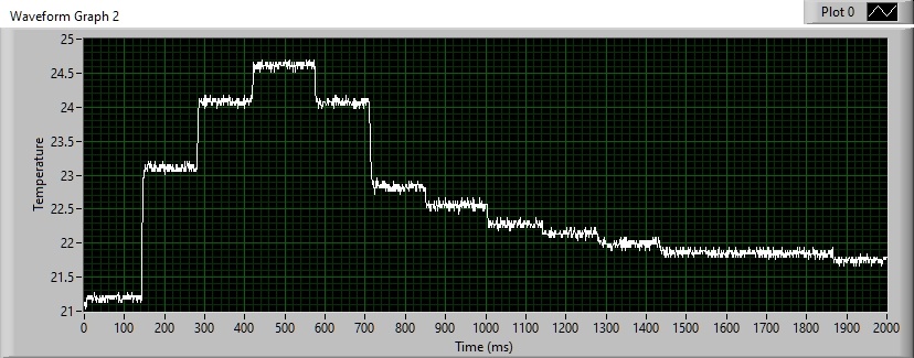

Well, the rise time is something like 20ms but mine has a sample and hold of about 150ms. A 1 sec heating curve turns into 150ms steps. (shorter pulse at 1kHz sample rate)
Sorry, but what does it mean? To have a reliable reading, do we have to wait 150 sec? I'll appreciate your clarification. Thanks
