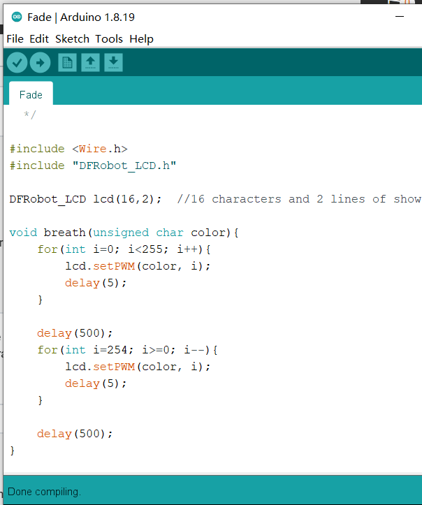

Backlight Doesn't work There is no function in your library to turn it on !!!!!! Please Provide a function to turn on the backlight. This cant be true
Are you using the sample code? Please use the setPWM function. You can adjust the brightness of the backlight through the setPWM function, the variable range is 0-255, 0 is to turn off the backlight.
example: https://github.com/DFRobotd...
