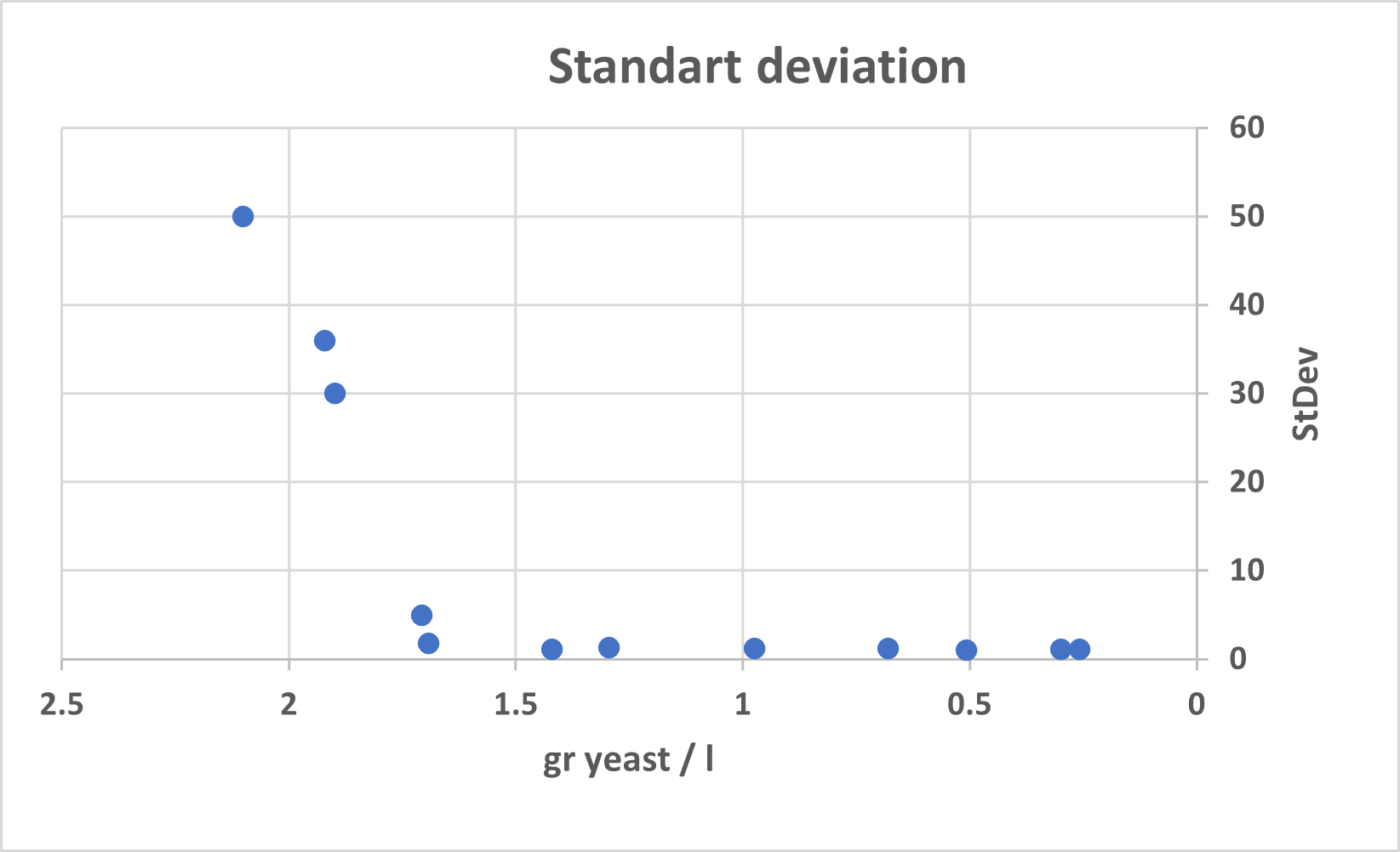

But when looking at the standard deviation values of the 60 readings used for the average, one can see that once a certain threshold is crossed, there's a huge variance.
This suggests that the previous graph does not represent non-linear behavior of the sensor but rather that beyond a certain threshold, it loses its accuracy significantly.
https://uploads.disquscdn.c... According to these data, the usable range of the sensor is much more limited.

2024-03-28 15:50:13
Could you tell us what kind of controller you are using? Like Arduino or ESP32, this looks a bit like an on-board ADC issue.

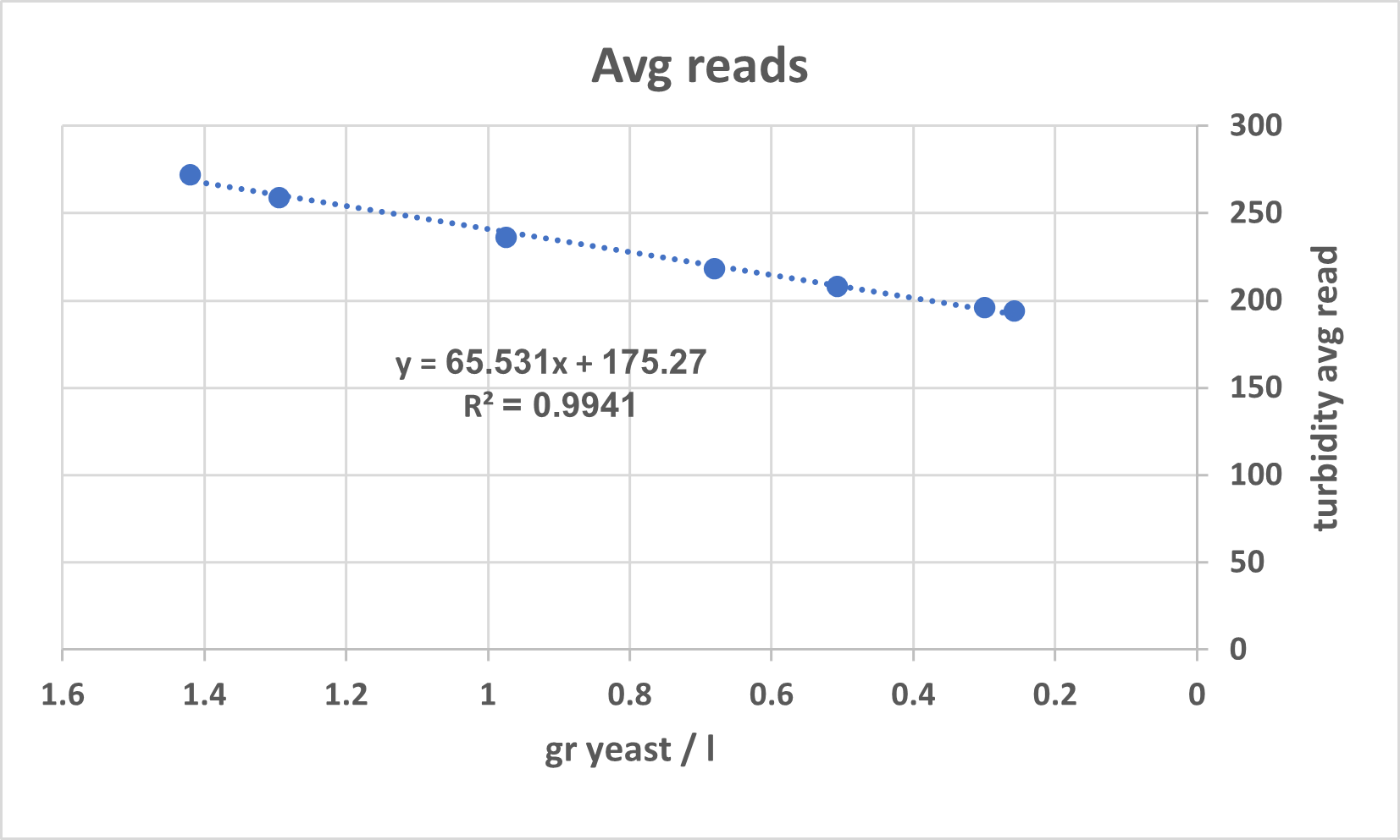

I used the sensor and I used the more accurate reading (which comes back from the sensor in two parts).
For the measurement, I used a yeast solutions in 0.1 molar salt (for obtaining a uniform solution that simulates turbidity from a microorganism. The salt is for stabilizing the status of the yeast by osmosis).
The value was determined based on an average of 60 readings. However, there seems to be some issue that I would like to consult with you about, and the details are as follows:
In the lower values, the reading is accurate and seems linear
