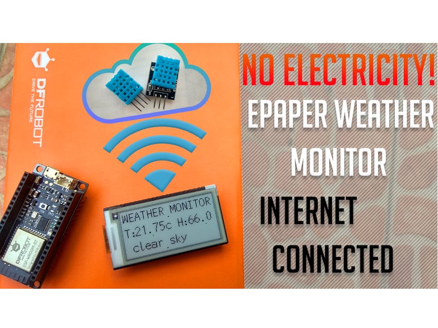

The ePaper display will display the weather info, synced with OpenWeatherMap API (over WiFi). The heart of the project is ESP8266/32.

Today we are going to make a project which is a weather monitor which displays all the weather related information on an ePaper display from DFRobot.
The Display is connected to an esp8266, you can use an esp32 as well with this display. The esp8266 is connected to the internet using wifi whose details can be changed through the code which I have provided on github. So lets get started!

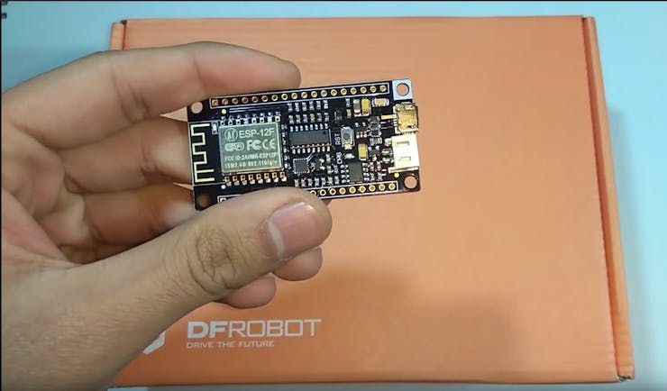

To make this you will need an ESP8266 board or an ESP32 and you can also add a battery if you want.

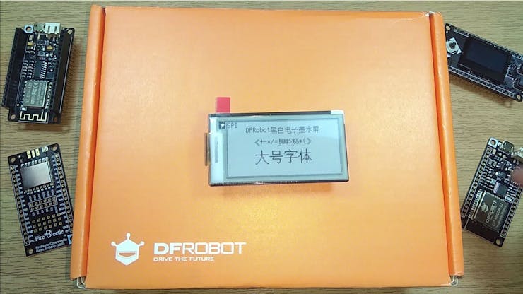

For the display I used an ePaper Firebeetle module.
I suggest to use a board from DFRobot with this module as the pinout will be compatible and you will face no issues anywhere, I used Firebeetle board from DFRobot as it has on board battery charging and monitoring solution.

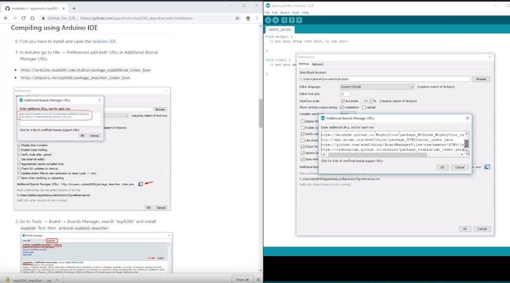

Step 2: Download and set up the Arduino IDE
Download the Arduino IDE from here.
1. Install the Arduino IDE and open it.
2. Go to File > Preferences
3. Add http://arduino.esp8266.com/stable/package_esp8266com_index.jsonto the Additional Boards Manager URLs.
4. Go to Tools > Board > Boards Manager
5. Search for ESP8266 and then install the board.
6. Restart the IDE.
Step 3: Connect the ePaper display to the Firebeetle Micro controller
1. Simply match & align white corners of both the modules and stack the modules on top of each other.

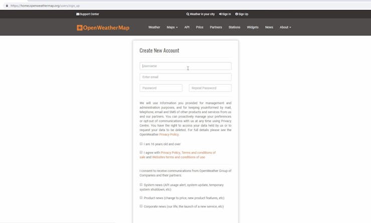

Step 4: Sign-up on the OpenWeatherMap.org
1. Goto the website.
2. Sign up with your email id and other credentials (FREE).
3. Once you are signed in, head over to the API Keys tab and copy your unique API Key which we will need in the next step.

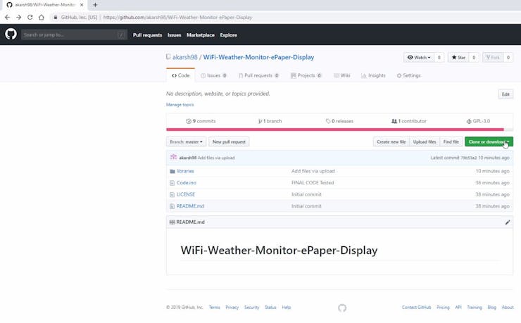

Step 5: Coding the module
1. Download the github repository
2. Extract the downloaded repository.
3. Copy the libraries from the downloaded repository to the Library folder in arduino sketch folder.
4. Open the Code.ino sketch in the Arduino IDE.
5. Change the Wi-Fi ssid and password in the sketch.
6. Add the API key from Step 4 to line number 44 of the code in place of the hashtags.
7. Navigate to Tools > Board. Select the appropriate board that you are using, Firebeetle ESP8266 in my case.
8. Select the correct comm. port by going to Tools > Port.
9. Hit the upload button.
10. When the tab says Done Uploading you are ready to use the weather monitor.

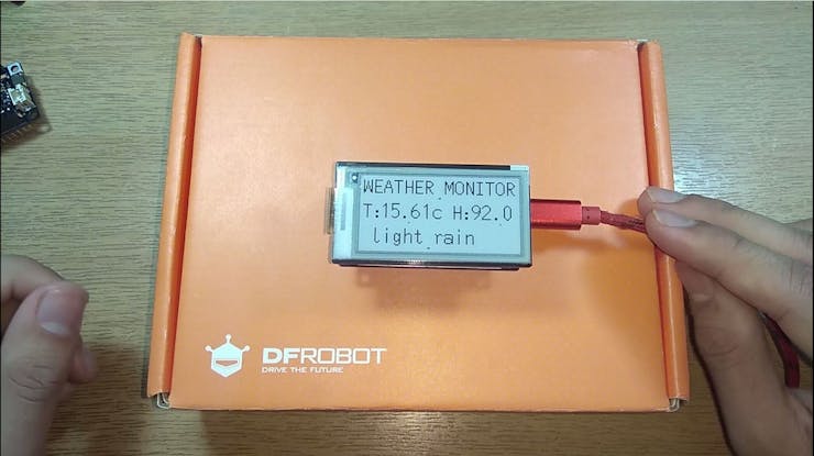

Step 6: Playing with the monitor
As soon as the module connects itself to the WiFi network the display starts refreshing and you will see the project coming to life.
