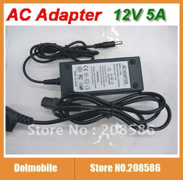

mariocarta 2012-10-06 07:55:58 Hello!
I'm a complete newbie to this battery world. I bought two of these batteries (FIT0137). After a lot of research I found that the best charger would be the IMAX B6. Since there's no one left in stock I ordered from DX. Today it has arrived.
Reading the manual, I discovered that to charge it I would need a 3 pin JST conector (since it's 2 cells) and it doesn't allow me to charge anything above 3.7v with the 2 pins conection.
Now on this post, it seems that I don't need anything but a AC/DC converter with 9v and 5A. Am I right? Is it something like this?
Can I use the 12V / 5A power supply that came with my IMAX B6 charger?
And, could I trick the IMAX B6 to work with the battery? I'm asking this to be able to know when the battery is fully charged.
Thank you for standing me!
