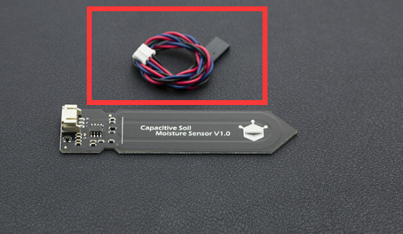

Hi there, https://uploads.disquscdn.c...
Do you only need such cables?
You can search directly for PH2.0 cable.
