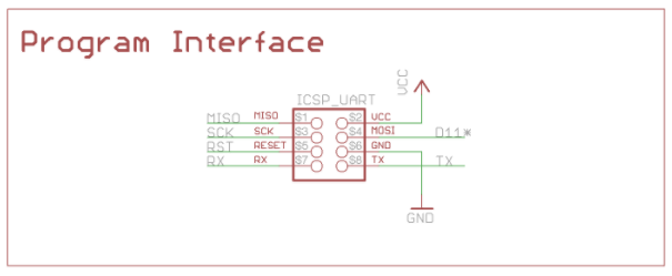

On the backside of the µHex, there are 6 solder pads, and two through holes, near the VIN and GND. What are they for? I can't find any documentation on them.
These are the pins of ICSP, and the square solder pad is the MISO pin. https://uploads.disquscdn.c...
