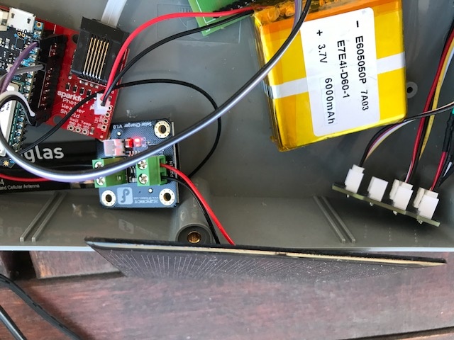

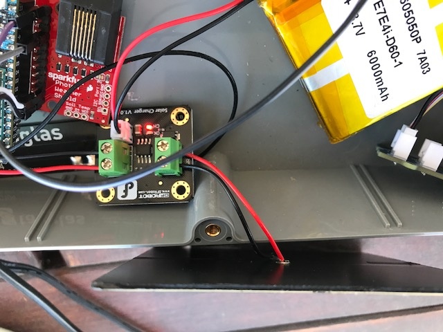

HI, this is not arduino module, the problem is not the output I think is te module that did not switch correctly from charge to power out
I know, what I mean is to test if the charging function is good, you can give a power supply (from 4.4V to 6V, don't have to be a solar panel), and see if the battery can be charged
2017-09-12 14:14:01
2017-09-11 14:53:47
Red light only, with and without the bat connected, see attached pictures.
Thank's
https://uploads.disquscdn.c... https://uploads.disquscdn.c...
What do you connect in the VOUT socket, I think you just need to connect the solar panel to PWR socket and the battery to the white socket

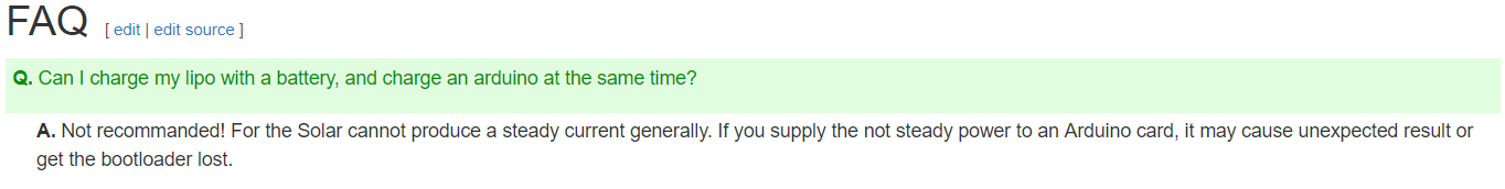

Here is an FAQ in the wiki, please don't charge the battery and the Arduino at the same time
2017-09-11 16:15:12
2017-09-11 16:16:19
