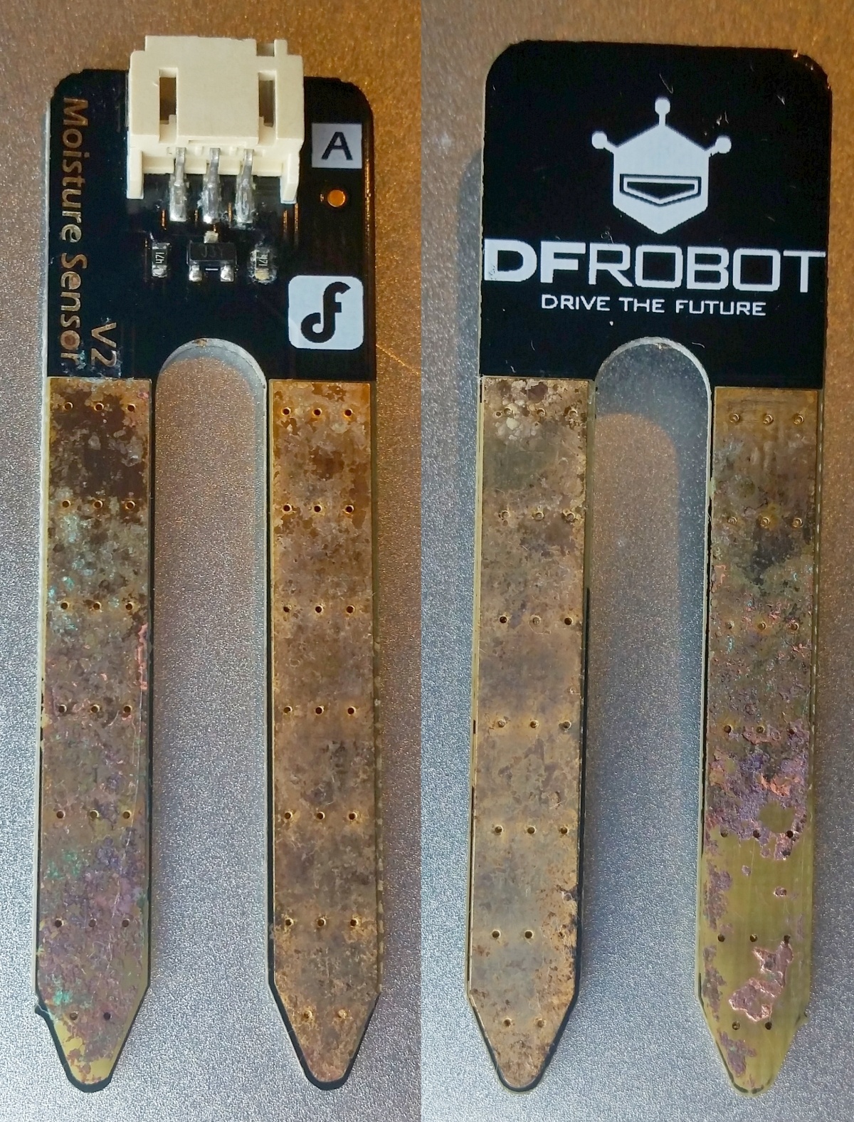

Corrosion of the Moisture Sensor (SEN0114) after 2 months of use in a pot with ECODUINO, data sent is SOIL MOISTURE 0 so the pump emptied the whole water tank, water everywhere :( , so unreliable because of this sensor https://uploads.disquscdn.c... .
Danut, thanks for sharing this experience. It looks like we need to build a fail-safe element into the program. Shutting down the pump when it is ON for too long might be an option.

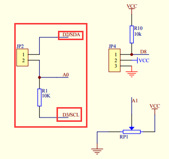

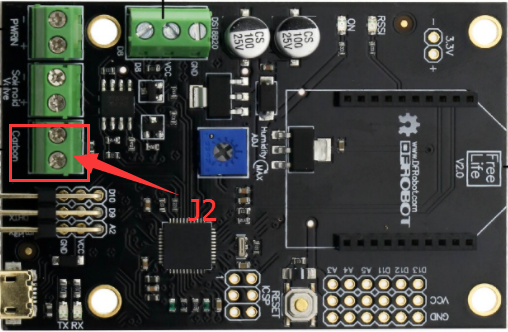

Thank you for the answer :( lol i finally burned the small oled display by reversing polarity. It must by an universal adapter with display to print the serial monitor data received via micro usb from any arduino device.
I am so sorry that I checked the schematic and found that the I2C is exist, it is the carbon sock. https://uploads.disquscdn.c... https://uploads.disquscdn.c...
