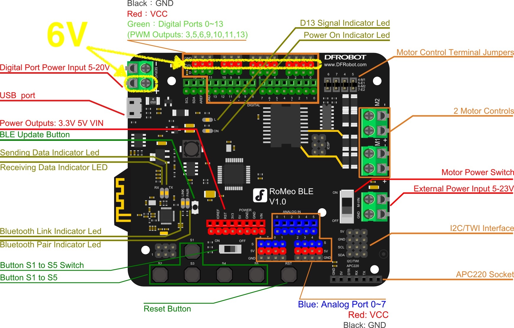

Sorry for the ambiguous specification of Servo port. We will later modify this part in our wiki page.
Here is the detailed explanation:
https://www.dfrobot.com/wik...
###Servo Power terminal
* It integrated an external servo power terminal. The range of this power input is about 5~12v. We recommend you to use 5v. So the servo power supply extension won't break the digital sensors connected to the 3p digital sensor interface. However,for driving 6~12v servos with the voltage input higher than 5v, it's not available to extend 5v sensor on all the digital sensor interface anymore.
* The servo power terminal won't supply system working voltage.
In your case, we recommend get the 6 V (4*1.5V) from battery and connect to Servo port.
However noted that all the VCC port of the digital port will be 6V. https://uploads.disquscdn.c...
