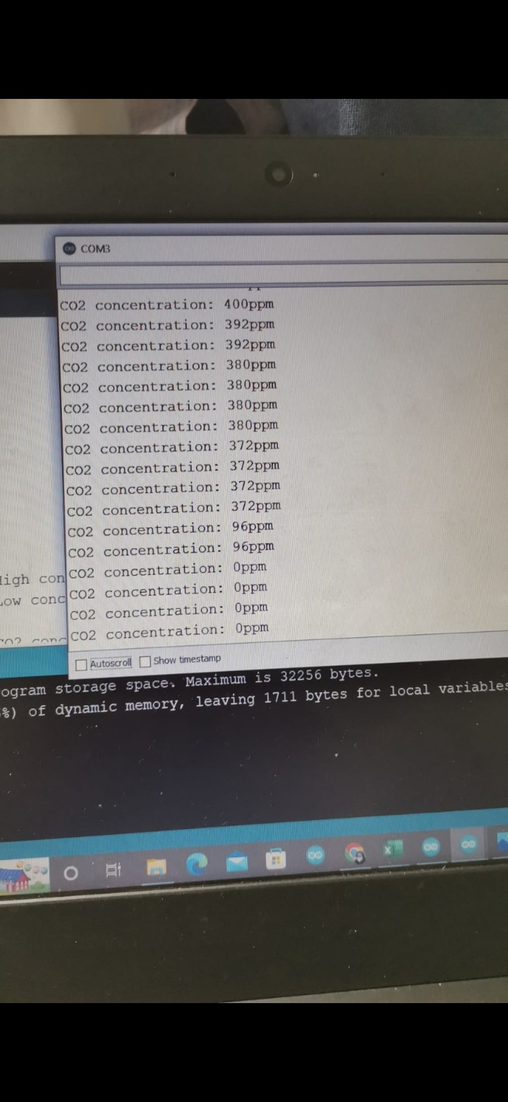

Hello, my sensor first read is 410ppm, but it will turn to 0ppm, but when i breath to the sensor the ppm is increase then back to 0ppm. is the sensor broken? https://uploads.disquscdn.c...
I have the same problem. Does anyone have a fix for it yet?
Code was copied directly from product wiki, data collected using Arduino nano.
Initial ppm exactly at 410 ppm then goes to 0ppm after 20 readings

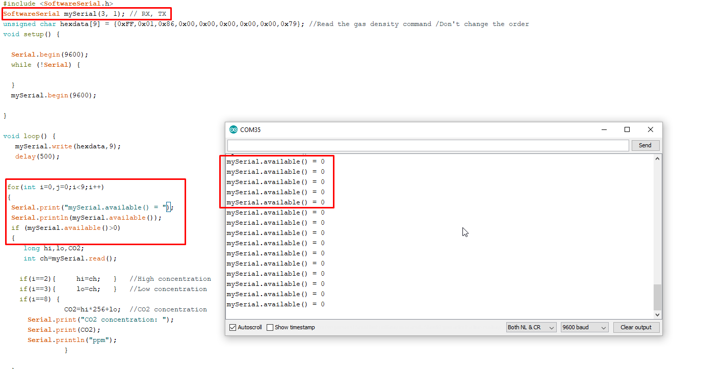

firebeetle cant use the software lib.and we don’t know the specific reasons.
but you can choose to use a hard serial port,esp32 has 3 hard serial port

This is the output. Also I am using pins 3 and 1 for RX and TX respectively.
2019-10-17 18:22:46
Hi, I am not able to take any measurements. I am using the firebeetle board. myserial.available is equal to 0 constantly.
Do you have any suggestion?

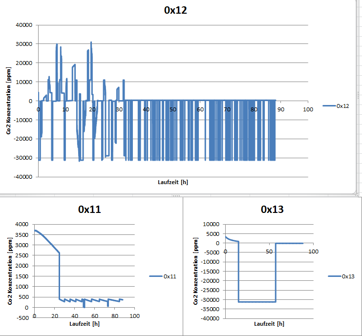

Is the Sendor shielded against electrosmog?
The four Sensors are printed wrong values such as -31000, or 10. The running time was 88 hours and sometimes they are printed wrong values (see at the picture). I have alreeady done the calibration with the four purchased sensors. In "normal" ambient they run perfectly.

I left the co2 sensor on and the arduino uno is connected on my laptop, in order to record sensor readings, I will attach the sensor readings here. I hope you could help me with my problem. Thank you
