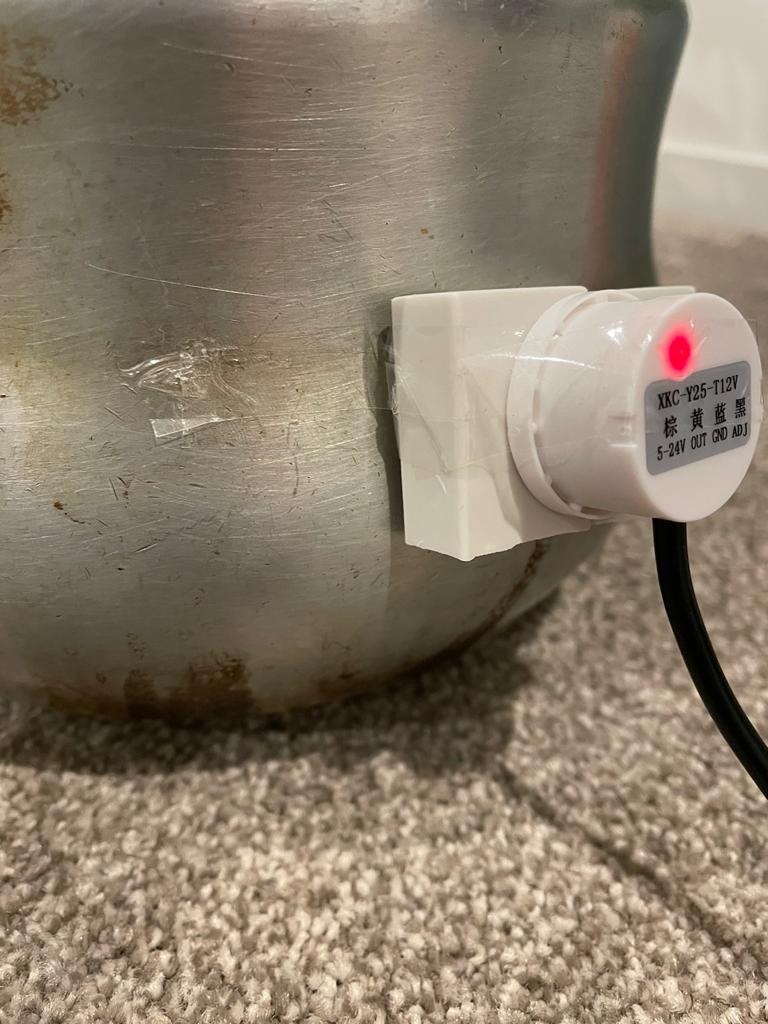

Hi Team, I have conformed to the documentation, Added rubber padding between the sensor and metallic container but still the sensor always shows that liquid is present; even for an empty container. Very BAD EXPERIENCE with this sensor. I have attached a photo of the setup. https://uploads.disquscdn.c...
Don't the specs of the sensor say that it won't work for metallic containers, non-metallic only?
