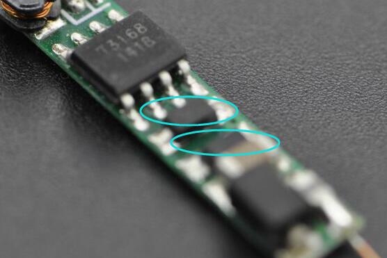

2018-06-06 16:10:47
The diodes should be the two next to the chip. https://uploads.disquscdn.c...
