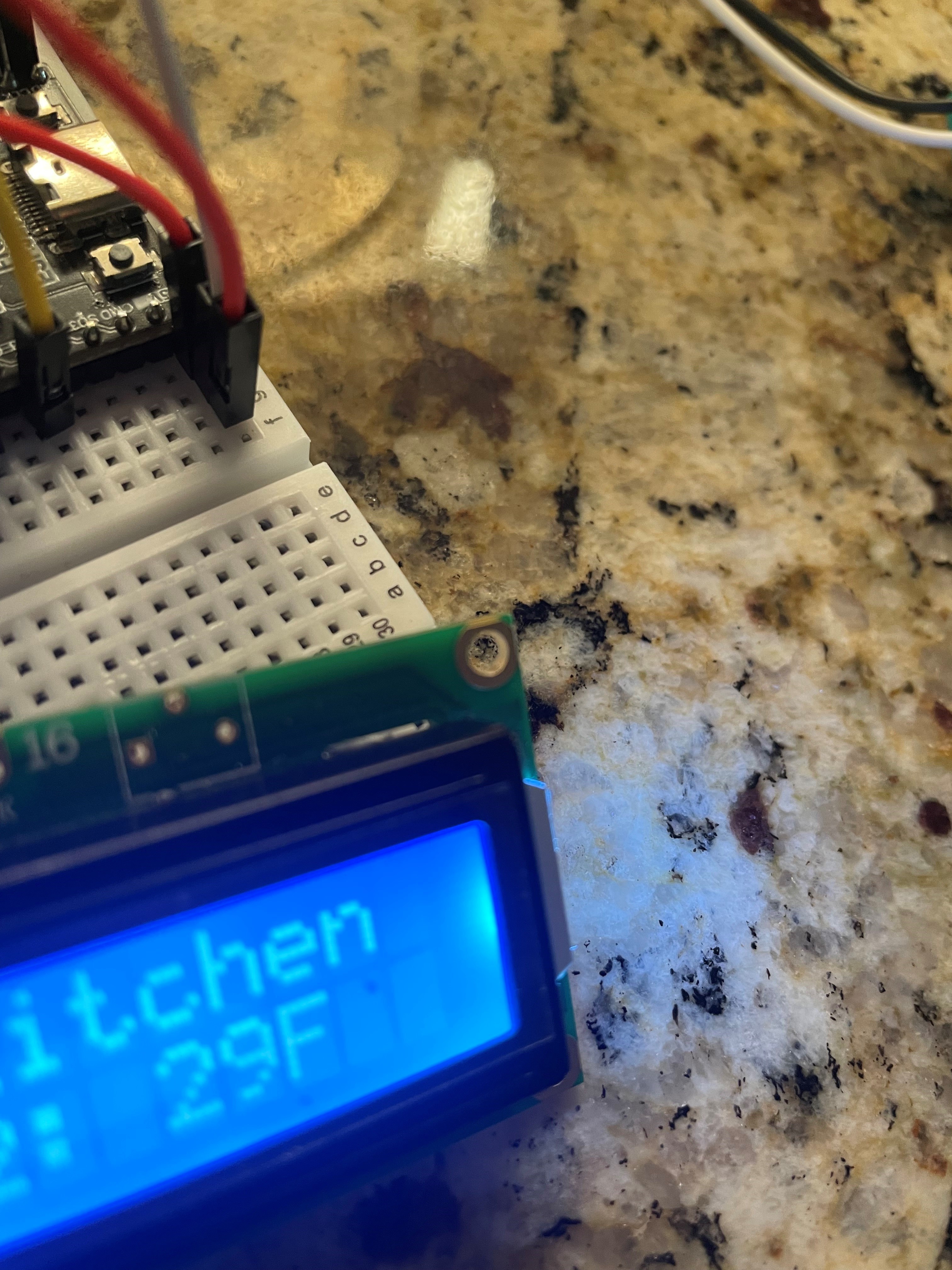

After we reviewed your pictures, we suspect that the metal shielding of the sensor probe cable is being interfered with.
This would cause the readings to be off if you have induced electricity in the metal ** of your oven. You can try the following to improve this:
1. Check that the metal enclosure or the oven as a whole is not grounded.
2. Put a separate wire from the shield to ground.
3. Wrap the probe cable directly with insulating material to avoid direct contact of the metal shield with other metals.
2024-05-15 20:15:22
When the sheath touches the stove the temperature readings are wrong.
2024-05-15 11:11:42
Hello, I just hooked this up and it seems to read room temperature just fine, no problems. The issue I am running into is when the insulated wire on the probe touches the metal on the stove, the temperature scrambles and returns bad data. This probe will basically be useless in this scenario as it won't read a temperature when the probe is in the oven. Any suggestions? Thank you.
