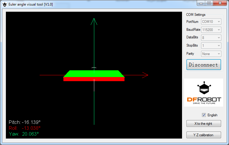

There is another problem. Euler angle visual tool [V1.0] .exe works but not correctly. The program receives data, but the object remains fixed. Maybe I need to install some additional software for proper functioning? https://uploads.disquscdn.c...
That's wierd. The program detects tilting angles, but the graphic stay unchanged. There's something wrong with rendering. Maybe try with a different computer?
