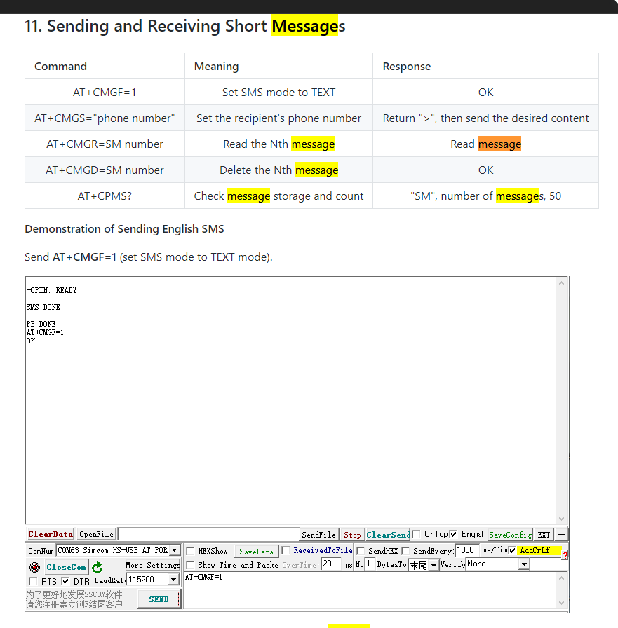

Hello there,
You can find the arduino tutorial on our wiki.
wiki: https://wiki.dfrobot.com/SI...
This product is adapted to the global network.
Our wiki also has tutorials on sending and receiving SMS.
