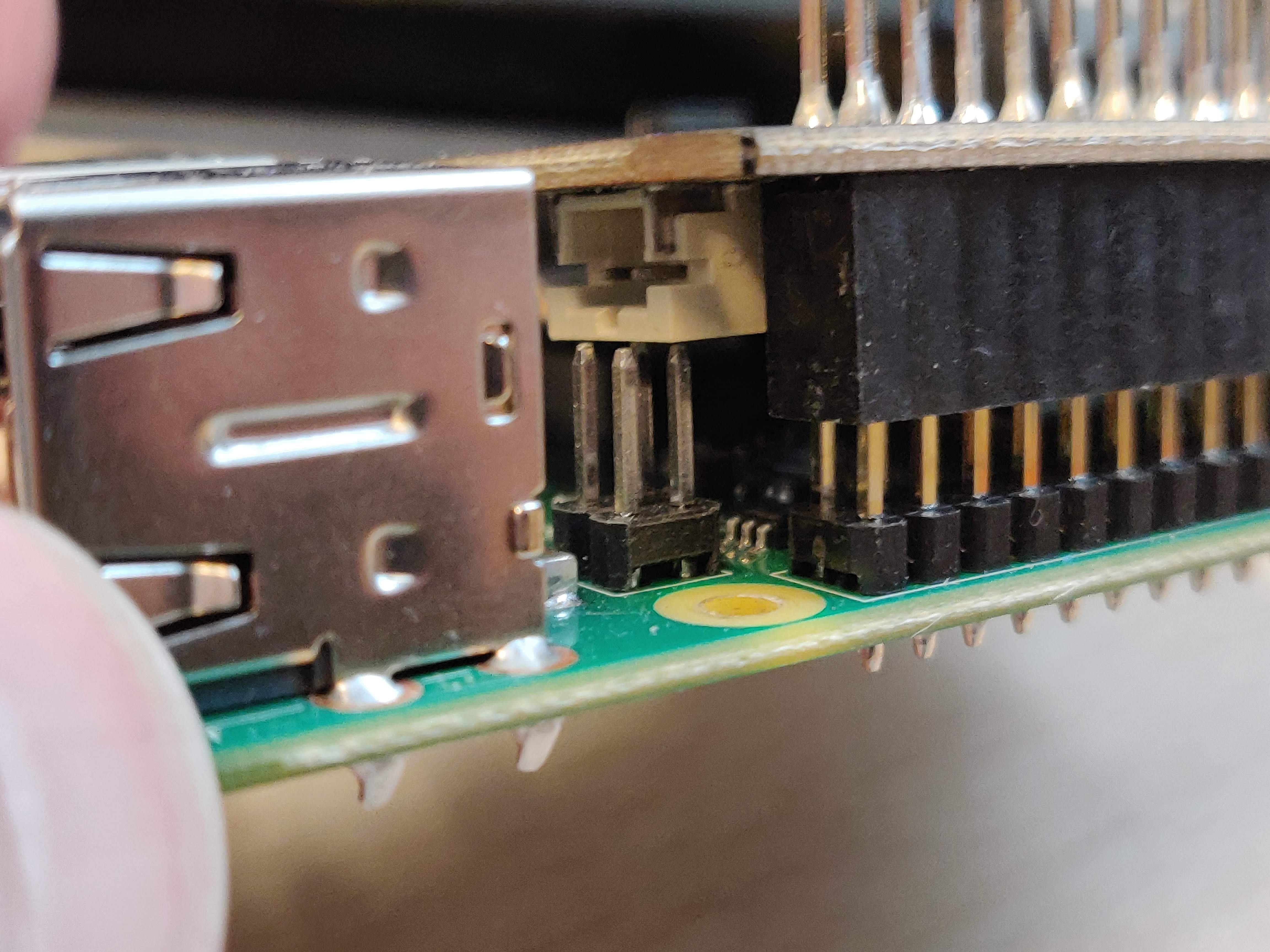

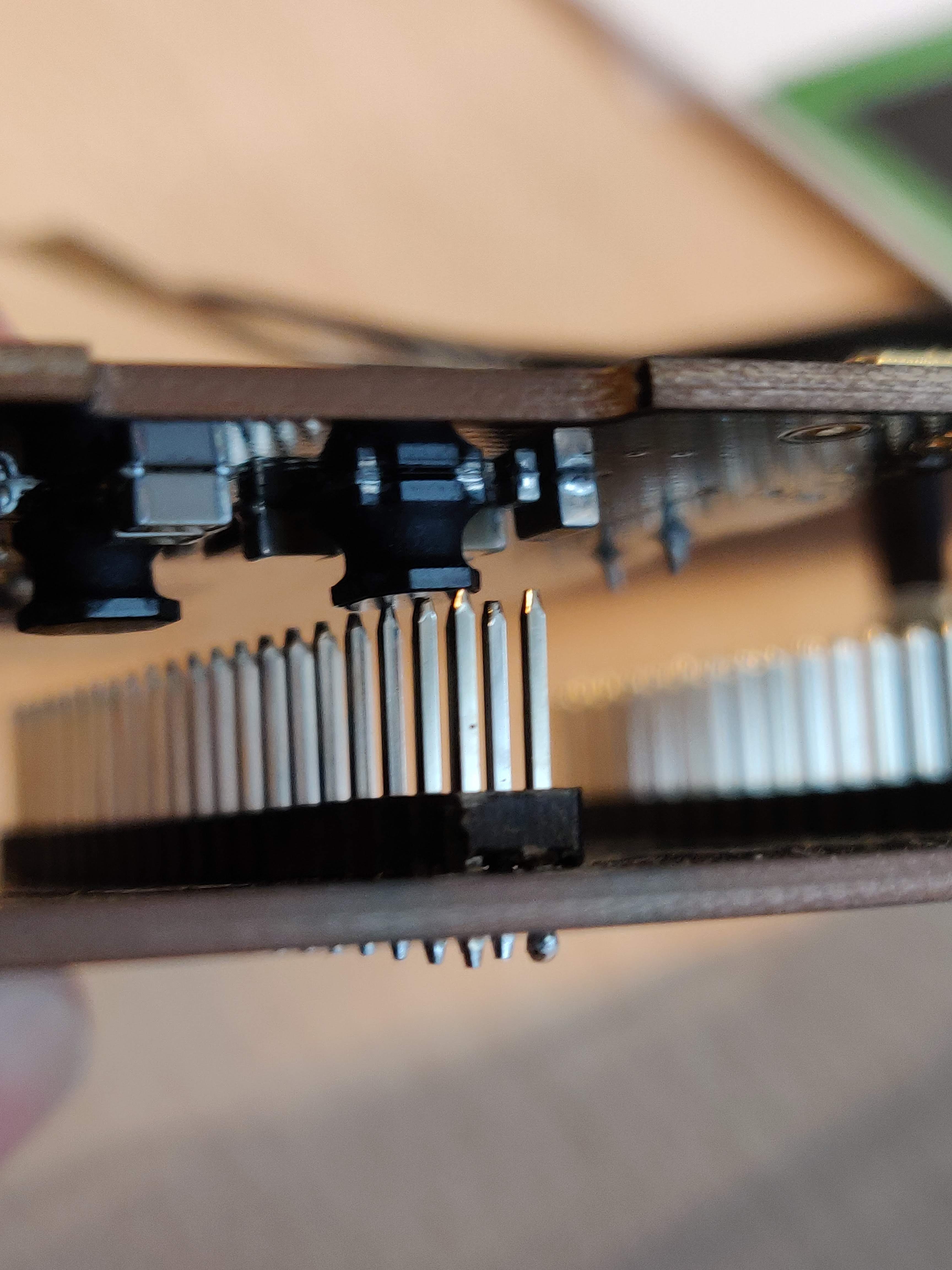

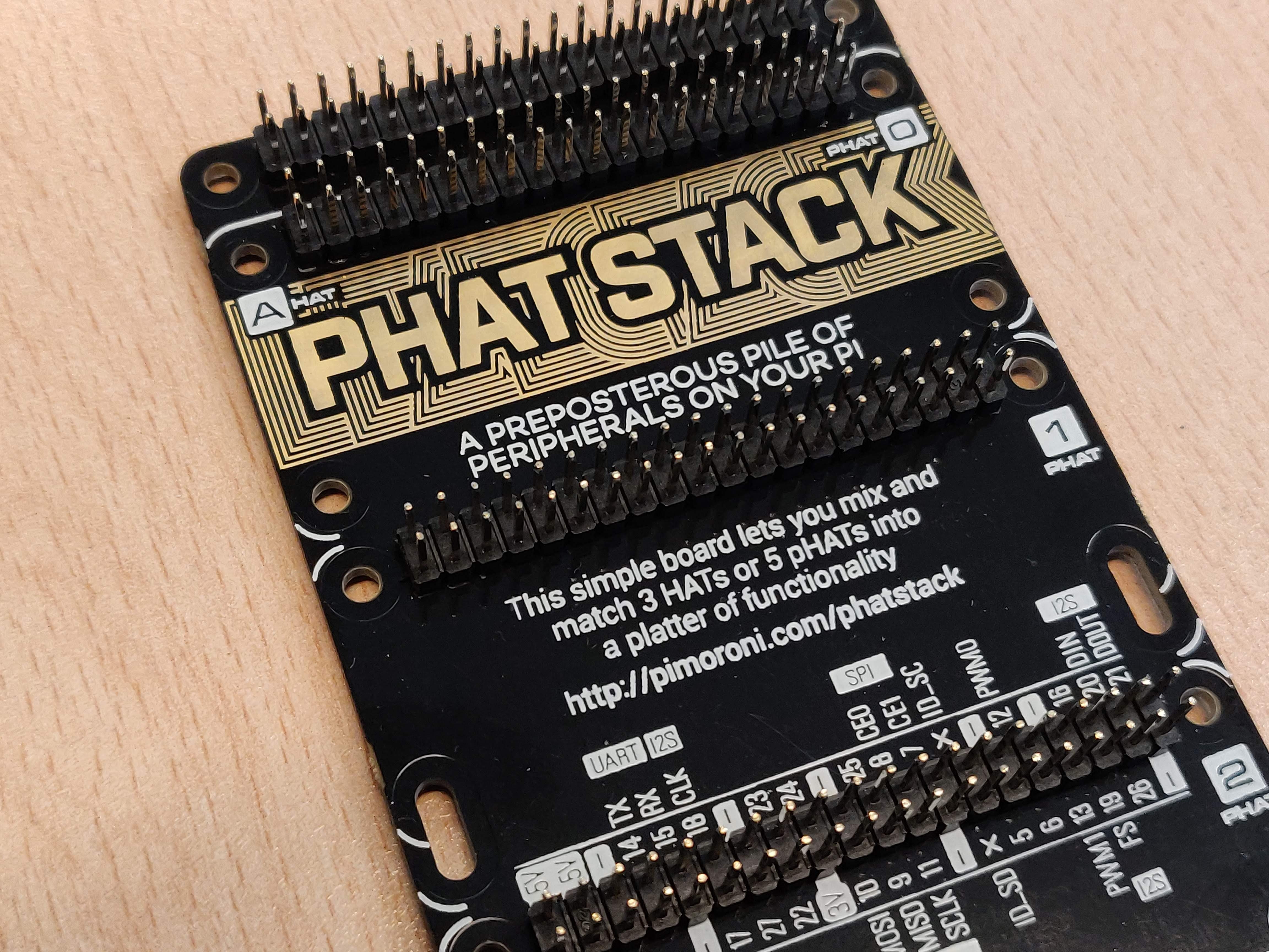

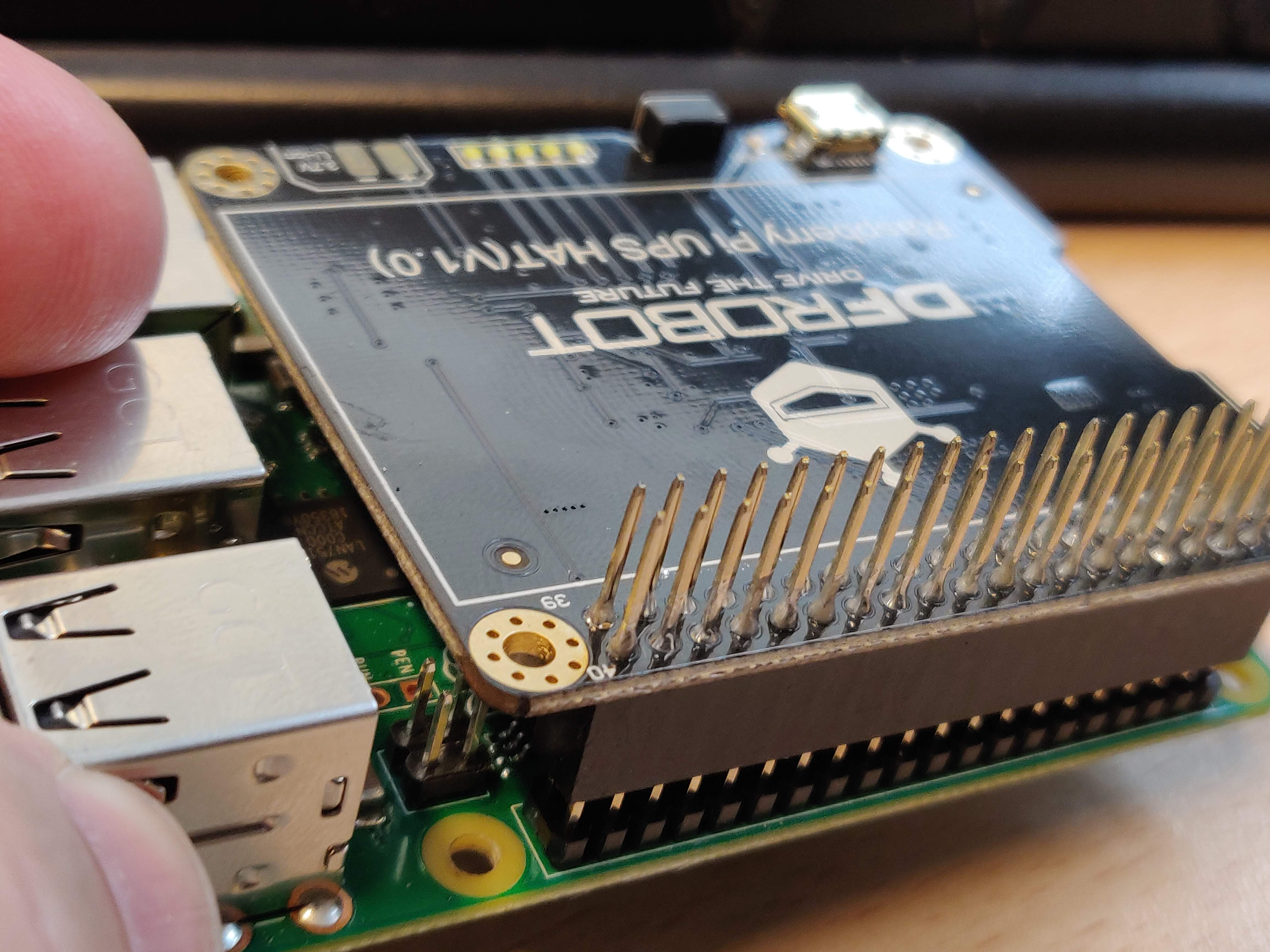

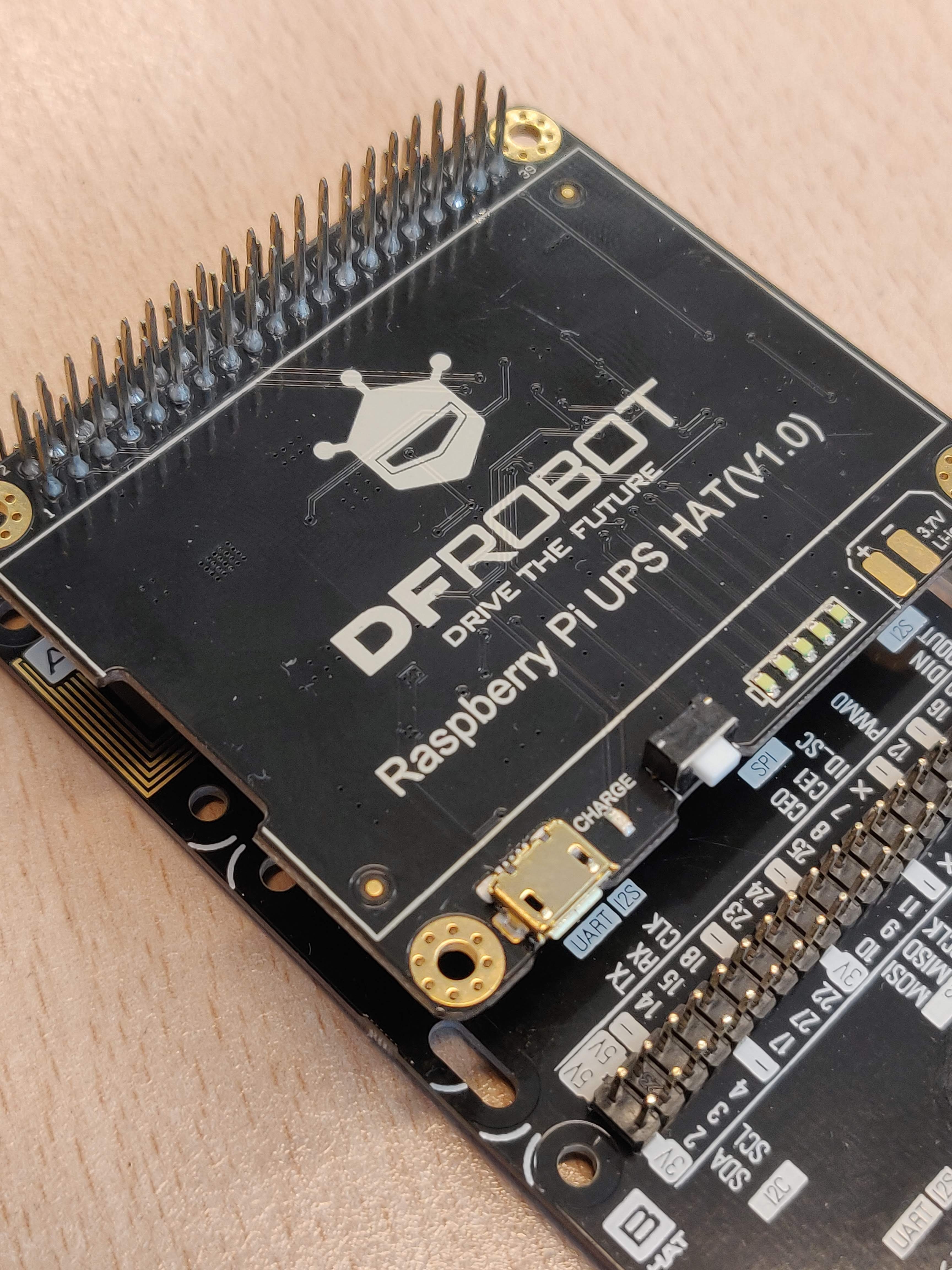

Hello support,
Last week i ordered one UPS and got it delivered yesterday.
The first thing i encountered, is that the battery connector is on the same position as the 4 pins on the RPi 3B+
This way i cannot fully connect the HAT on the Pi...
You must have noticed that too!
Second thing is, some components on the back side 'touch' the pins when i use a 'Phat Stack'
I added some photo's to support my findings...
https://uploads.disquscdn.c... https://uploads.disquscdn.c... https://uploads.disquscdn.c... https://uploads.disquscdn.c... https://uploads.disquscdn.c...
Hey Robert,
Thanks for your feedback and your observations are noted. Unfortunately we did not test compatibility with the PHAT stack since it is a third party product. A simple fix for this would be to add some sort of insulator between the exposed pins and the components being touched, such as tape or another non conductive layer. As for the 4 power pins, we were still able to successfully use the board even though it was not fully seated due to the extruding pins. If you are having trouble with your setup and would like us to help you out in a better capacity, could you please email [email protected]

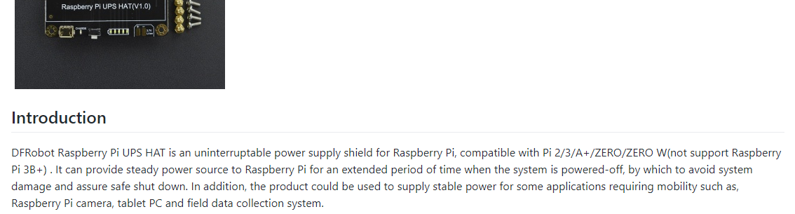

According to the wiki, this HAT is not suitable for the RPi 3B+, but i at some resellers, they claim the RPi 3B+ is supported.
Can someone give me the correct answer?
Thanks in advance!
