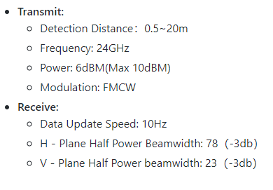

The device will work for high velocity devices. Although we do not have a defined top velocity, you can check the data update speed below:
Since distance between the sensor and the object you are measuring affects the top velocity (since determine the time it takes the wave to respond is dependent on distance), we can not give you an exact value.
