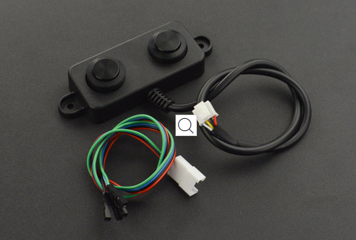

Is it possible to get it with longer cable?
This sensor shipped with the PH2.0 Female to dupond female wire.
So you could make it longer by using the dupond male wire.
But since the UART of this sensor is at TTL level, it can only transmit a distance of a few meters.
And please use high quality wire.

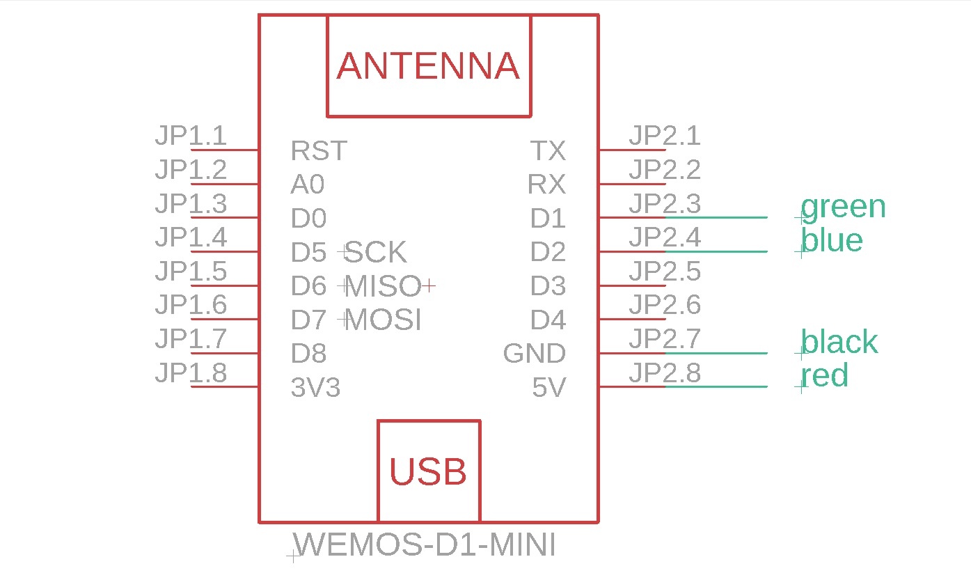

I use this code in esphome:
https://community.home-assi...
The connections are as in the image. https://uploads.disquscdn.c...
uart:
tx_pin: 4 # Transmit Pin: 4 (D2)
rx_pin: 5 # Receive Pin: 5 (D1)
baud_rate: 9600
