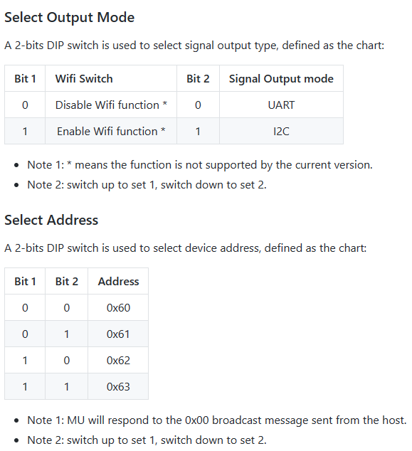

failed to initialize MY! Please check protocol version or make sure MU is working on the correct port with correct mode. mu vision sensor
what to do now?
Please check the switches on the MU sensor.
