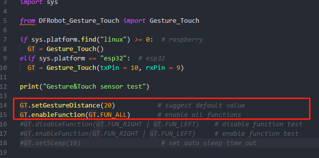

Hi doug and Lorn,
Sorry to know about your inconveniences. We just tested on raspberry pi 4. It works fine. Few things to pay attention to:
1. Make sure you are using 5v to power the sensor.
2. Make sure, you use the default distance (if you find the performance isn't good), all the functions are enabled and setsleep is disabled or set to very low value.
Hope that helps.
