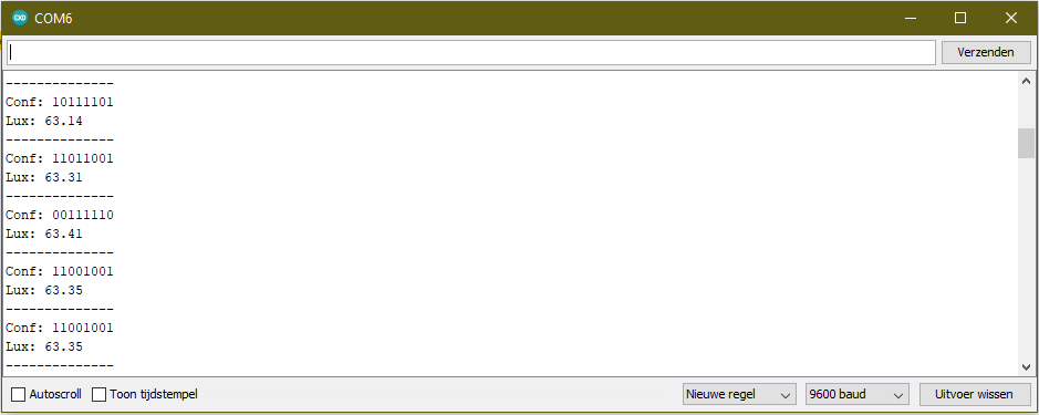

2022-11-04 10:07:34
Hi, Could you please send us your revised code?
Code used:
#include <dfrobot_b_lux_v30b.h>
DFRobot_B_LUX_V30B myLux(0, 9, 8);
void SPrintZeroPadBin(uint8_t number) {
char binstr[]="00000000";
uint8_t i=0;
uint8_t n = number;
while(n>0 && i<8){
binstr[8-1-i]=n%2+'0';
++i;
n/=2;
Serial.println(binstr);
void setup() {
Serial.begin(9600);
myLux.begin();
bool ok = false;
while(!ok){
int result = myLux.setMode(myLux.eAutomatic,myLux.eCDR_0,myLux.eTime800ms);
Serial.print("result: ");
Serial.println(result);
ok = result == 1;
void loop() {
Serial.println("--------------");
Serial.print("Conf: ");
SPrintZeroPadBin(myLux.readMode());
Serial.print("Lux: ");
Serial.println(myLux.lightStrengthLux());
delay(2000);
This is the output of the serial monitor:
The Config read from the readMode() function seems to be completely random. For example, according to the API's header file, bit 7 and 6 should always be 0 in Automatic mode.
