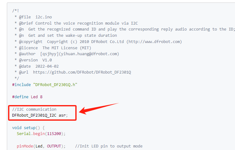

If you use DFRobot_DF2301Q_I2C to instantiate the object, you won't use the UART at all, and please note that the on-board switch must be kept on I2C and not UART.
Or are you able to describe in detail how the UART generates interference?
