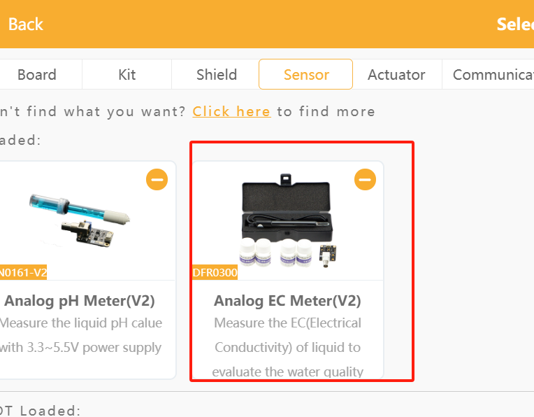

Can this be used on microbit?
Is there any program that can be used on microbit?
If there is a program available, I would be very grateful.
Yes, this one could be used with the MicroBit.
And we only provide the Mind+ Blocks as well:

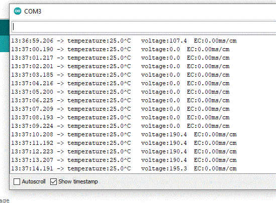

Hi DFRobot,
I did the EEPROM and still the same result. EC still 0.
Voltage from 0 to 200 after inserting into 1413 solution.
Please advise.
