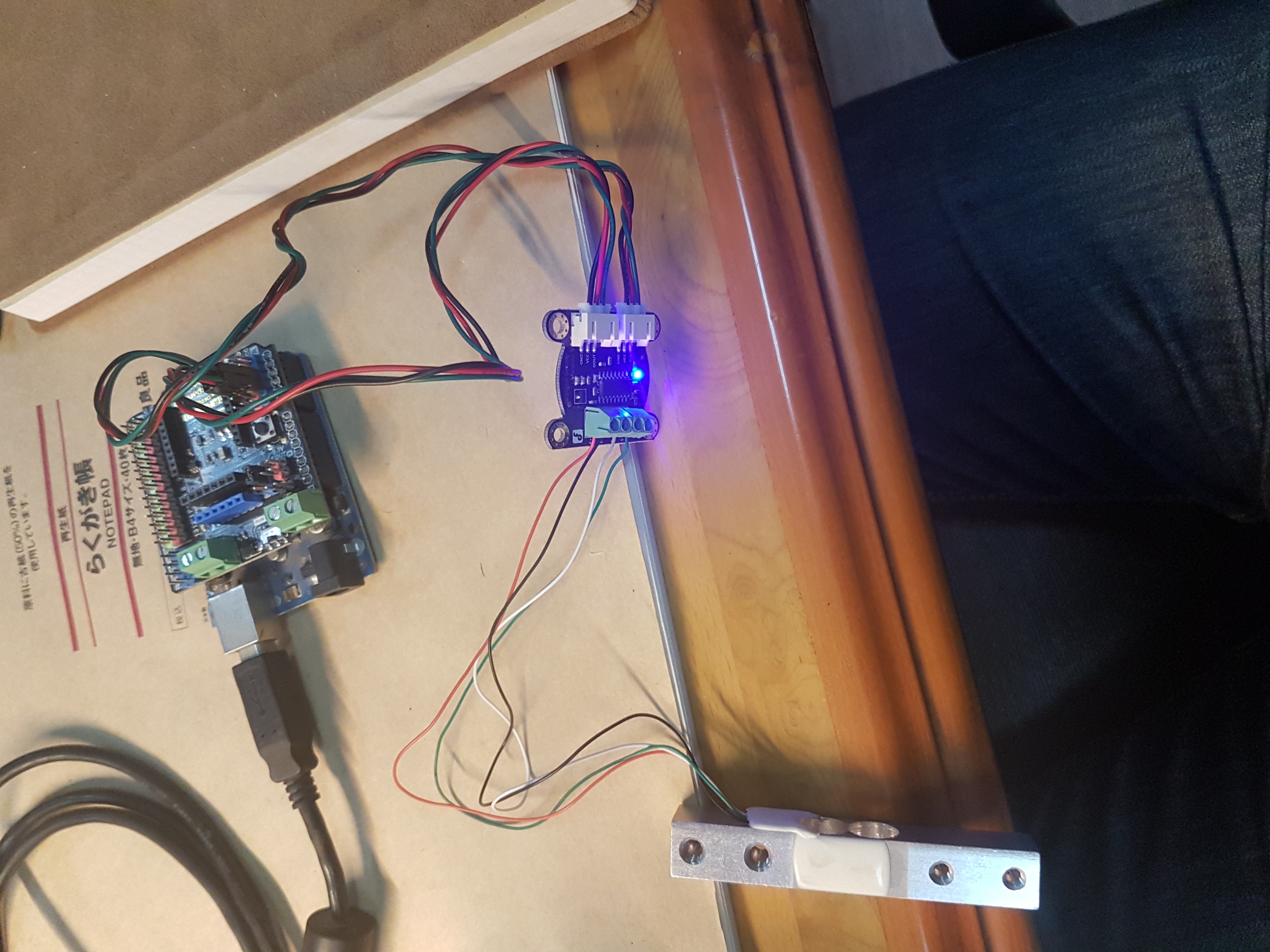

Hi, what about your diagram? Did you try to check if it is correct? And please make sure the board and the serial port you choose is also correct. When you open the serial monitor, the baud rate is 9600, right? Maybe some pictures would be better.
Dear Wendy, Thanks a lot for your help dear, the connections is correct as you can see in the photo attached , the baud rate is 9600. please let me know what to do to get the weights correct ? https://uploads.disquscdn.c...
