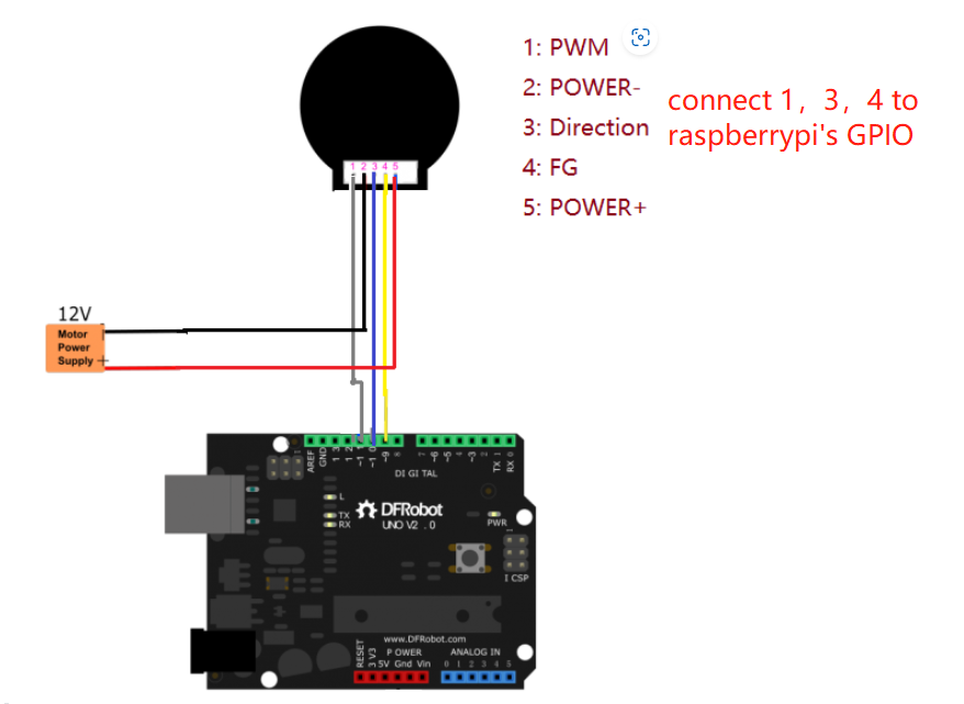

The wires on my motor do not match the Product Wiki. They are Blue - Black - Yellow - Green - Red. They certainly can't be connected to an Arduino as they require 12V. What type of...
userHead JaneYu 2016-12-18 22:54:43 26 Views55 Replies
The wires on my motor do not match the Product Wiki. They are Blue - Black - Yellow - Green - Red. They certainly can't be connected to an Arduino as they require 12V. What type of connector does it use?

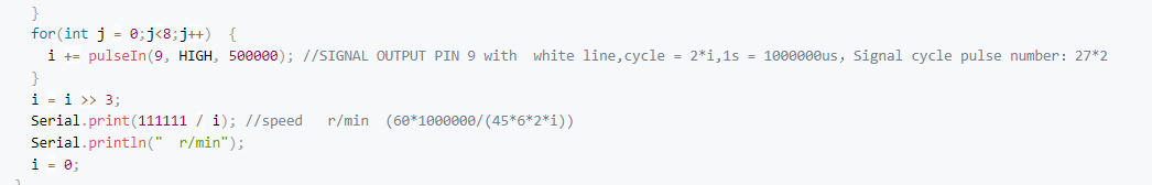

Hi, I am planning to use this motor for the project which requires to count number of revolutions. I tried counting interrupt signal for encoder through FG pin, but it seems like it doesn't work like normal hall effect sensor encoder or optical encoder works . How can I use this motor's encoder for counting revolutions per cycle?
Please refer to our wiki for the calculation formula.

Hey,
I have a query regarding this motor : SKU-FIT0441 BLDC Motor
My application for this motor requires to connect it with a Raspberry Pi 4B. Will it be compatible with it?, as the Datasheet only mentions work with Arduino.
And can I employ a separate external Motor driver(Arduno BTS7960B 5V Motor driver module) to govern the motor speed, or is it just not possible to overcut the internal controller (Specs on the internal motor driver will really be helpful)?
I hope someone can clarify this.
Thanks.
You can try driving a motor using the Raspberry Pi's GPIO pins. By utilizing the RPi.GPIO library, set the motor's PWM and direction to OUTPUT, and configure the PG as pull-up.

I have a strange problem where the motor has problem restarting after being idle for a few seconds. And it only happens when I try to turn in CCW (direction pin goes high). The signal is sent through my microcontroller (stm32f411re).
Here's the stranger thing: if I hook the pwm wire straight to gnd, and direction pin straight to 5V or 0V, it works.
I understand that motor is active low.
I'm experiencing the same thing Trần. I find that I can usually get it to wake back up by flipping the direction pin for a few microseconds.

Hi. I got one of these motors and plugged it in to an Arduino Uno and it works great - smooth, torquey and quiet. I can control the speed and direction. But in your sample code I don't understand what you are doing in the j loop. Why loop 8 times on pulseIn? What is the right bit shift (i = i >> 3) doing? Why divide 111111 by i ? And finally, why is cycle = 2 * i ? THanks so much!
