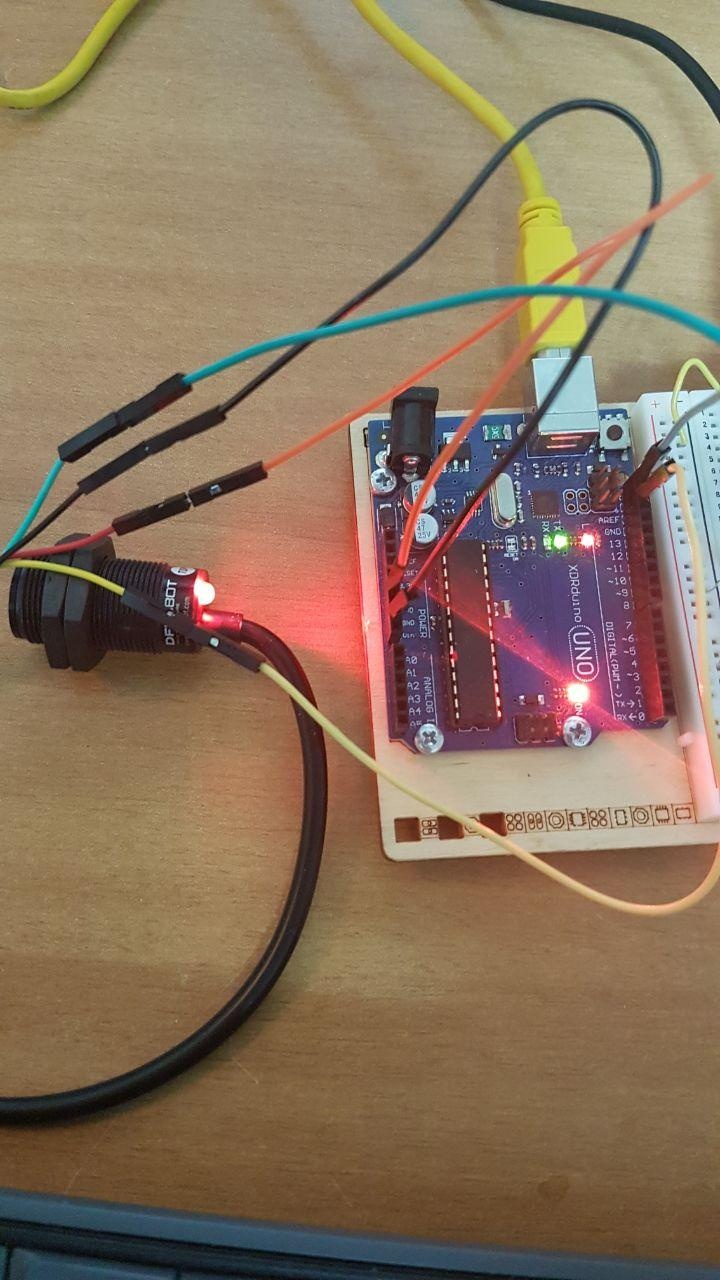

hi - just received 2 cameras. i uploaded the simpleDemo sketch to an arduino UNO and the readings i'm getting from the serial monitor are all 1023 - no matter where i point the camera to (i also set up 2 IR red leds). i use the most simple setup - just power, GND SCL and SDA - see attached picture. this is the same behavior with both cameras. https://uploads.disquscdn.c...
