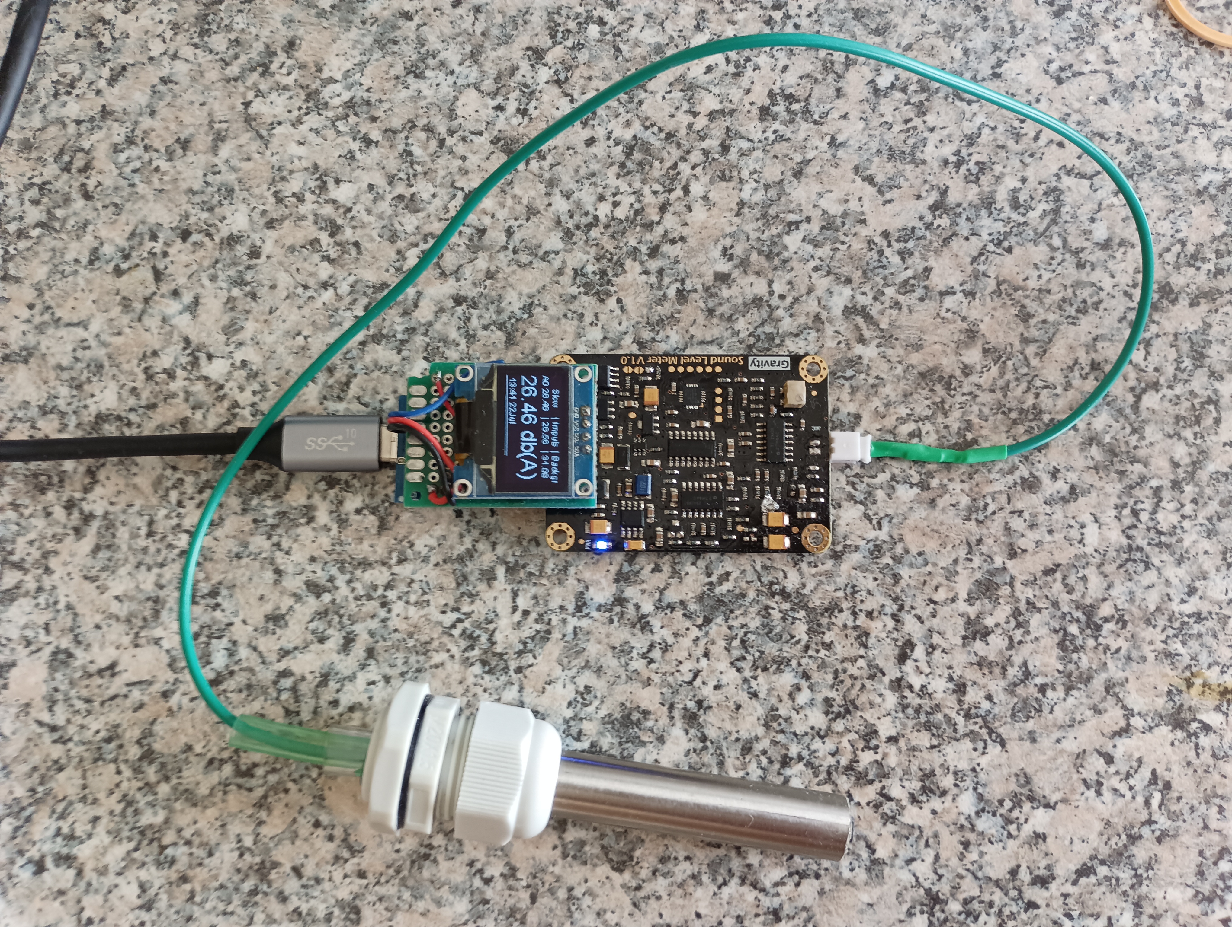

You have a pot on the module.
You may use another electret mic, but you have to mount it watertight in a 1/2" boom to recalibrate.
Please have a look on the last pages of
https://github.com/rin67630... with instructions on how to harden an electret mic for outdoor use and make it fit to calibrators.

Hi. Looks very exiting. Is there anyway to add a different microphone to the setup? For instsance for outdoor use etc. And is it then possible to re-calibrate?
You can, of course.
More or less every electret capsule will do.
There is a pot on the module to recalibrate.
Here the code for an absolute top-notch sound pressure level software:
https://github.com/rin67630/Sound-pressure-level-meter-Booster
