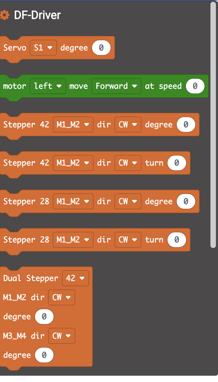

In PXT-extension, servo only works between 0 and 90 degrees. How do I have to make it work between 0 and 180 degrees
userHead JaneYu 2019-01-11 16:18:02 108 Views21 Replies

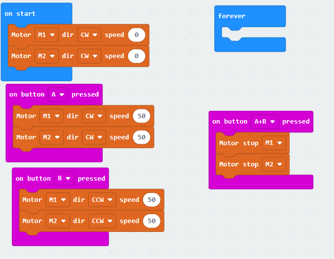

We tried using rechargeable battery but the motors seem to pull too much current when they first start and have overloaded our battery. How can we solve it? https://uploads.disquscdn.c... https://uploads.disquscdn.c...

https://uploads.disquscdn.c... Hi, Cant see the normal DC motor option in Microbit Makecode. Any suggestions.

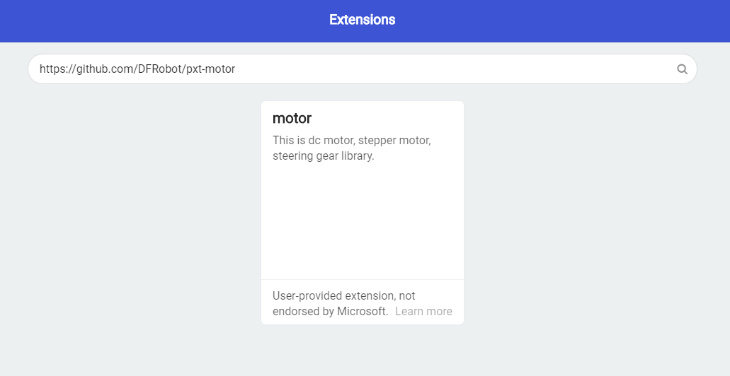

2019-08-05 13:36:34
Sorry for your inconvenience. You should add it manually. https://github.com/DFRobot/...
