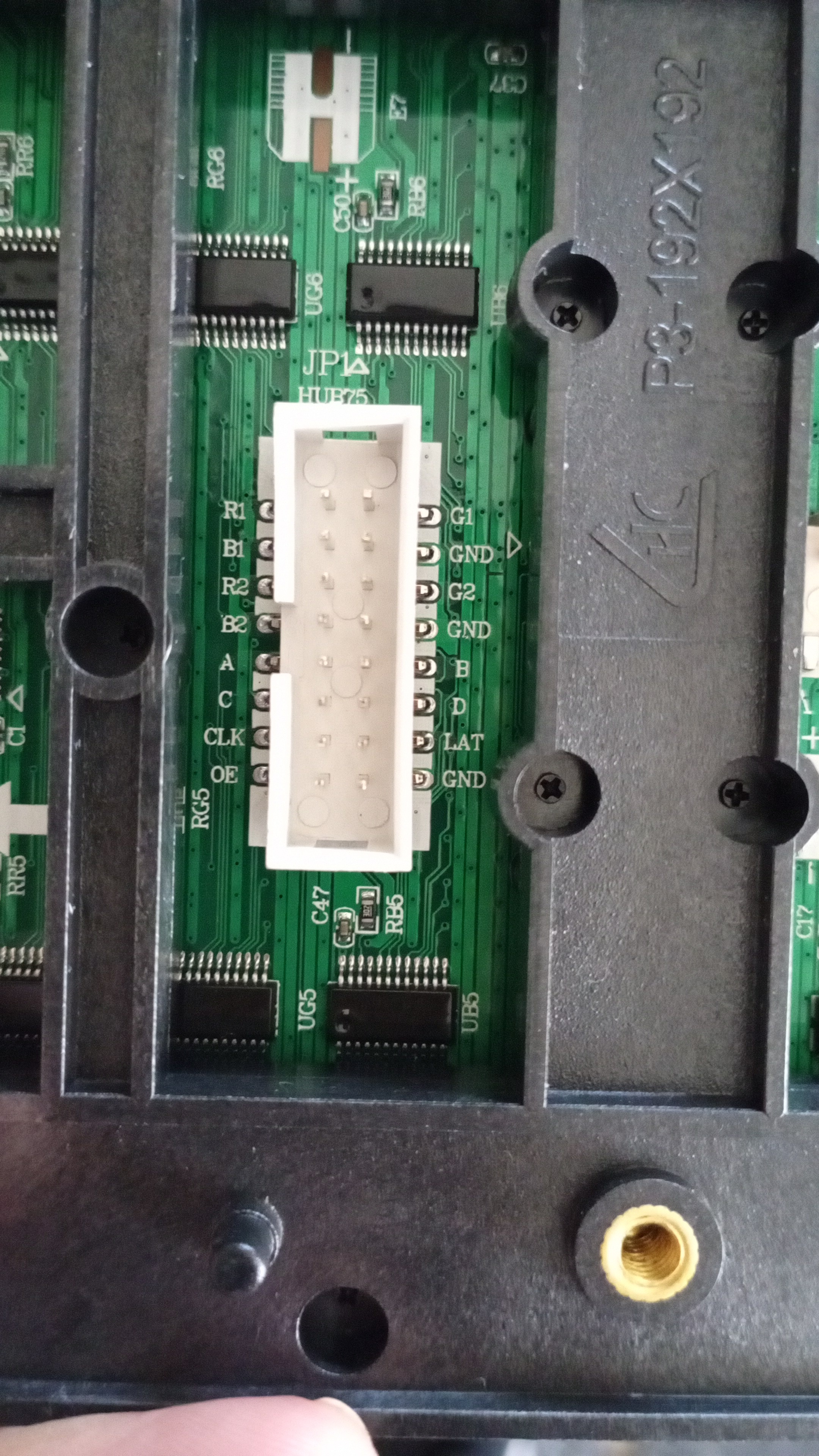

2022-08-08 21:11:36
I am using outdoor 64x64 rgb matrix, but there is no E pin on the board, how can I use the library whitout E pin?https://uploads.disquscdn.c...
