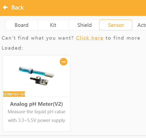

Can this be used on microbit?
Is there any program that can be used on microbit?
This pro version does not support MicroBit, but the normal one(V2) support the microbit.
We have the Mind+ blocks for it:

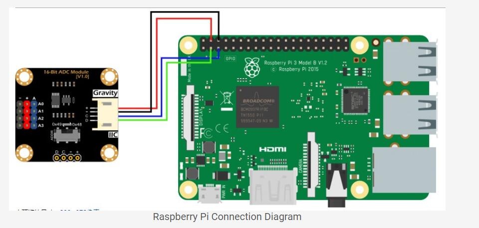

Yes, ADS1115 need to be connectted with raspberry pi SCL/SDA pins.
For more information about ADS1115, see the link below.
