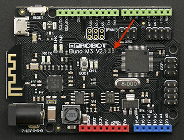

Hi, thanks for the info. I'm pretty sure I have v2.1, what is the hardware difference between v2.2 and v2.1 that would make it compatible with the Arduino IDE now? This is a bit frustrating as I don't see myself using this board now unless I can modify it to bring it to v2.2 specification.
Hi Dylan,
Be noted: The following hardware hacking may keep you away from warrant.
If you really want to use the official IDE, you can change R25 from 0 Ohm to 100nF capacitor.
